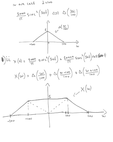

Here is a signal
\frac{5000}{\pi}sinc^{2}(50t) + \frac{10000}{\pi}sinc^{2}(50t)cos(100t)
Find it's Fourier transform and draw it
Standard Fourier transformations
Well
\frac{5000}{\pi}sinc^{2}(50t) = triangle(w/100)
So \frac{5000}{\pi}sinc^{2}(50t) + \frac{10000}{\pi}sinc^{2}(50t)cos(100t)
I get triangle(w/100) + 2(triangle(w+100/100)+triangle((w-100)/100)
However the answer says that there is no 2 (highlighted in red). Why note. The Fourier transform of cos(100t) is pi * [d(w+100) + d(w-100)] is it not? Where has the 2 gone?
where d is dirac
Thanks

G(w) =\int g(t) e^{-jwt}dw
Well, after messing around in Mathematica, I can see the two shouldn't be there. Show us your work so we can see where the problem lies.
From the mark scheme associated with the question
I did the same except got a 2 outside the last 2 terms...I didn't get a flat part in the middle (as the triangle sides didn't add to 1)
