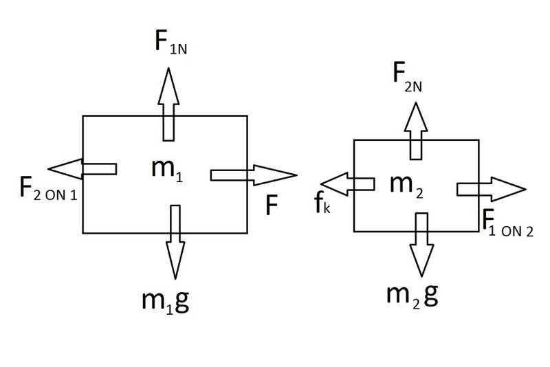

I was wondering if anyone can provide feedback on my free body diagram of two objects acting on each other. The question is asking for two separate free body diagrams. A force is applied to object 1, and object 1 pushes against object 2. Object 1 is on wheels and object 2 is in contact with the ground. The two objects accelerate. Find the constant for the kinetic friction.
I can confidently find the constant, as long as my free body diagram is correct. But, I would like some feedback on whether it's correct it or not.
On object 2, the vertical force is in equilibrium, F2N - w2. The horizontal force is F1 ON 2 - fk.
On object 1, the vertical force is also in equilibrium F1N - w1. The horizontal force for object 1 is a bit confusing. I'm assuming it's nearly frictionless, since it's on wheels. So is it, F - F2 ON 1? I guess it would be incorrect to subtract fk from the horizontal force on object 1, since it's only acting on object 2, however how does that friction force affect object 1?

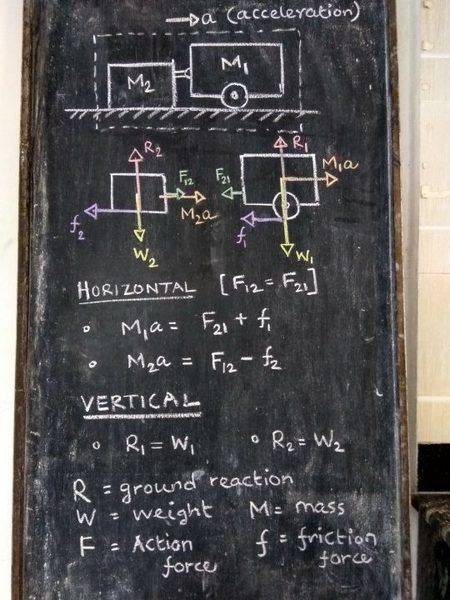

Hello Dear,
I do not know if they have asked for Both Rolling Friction for Object on Wheel and Sliding Friction for Object on Ground.
But if Rolling Friction is to be Neglected then f1 = 0 will be used.
See the Picture Attached.

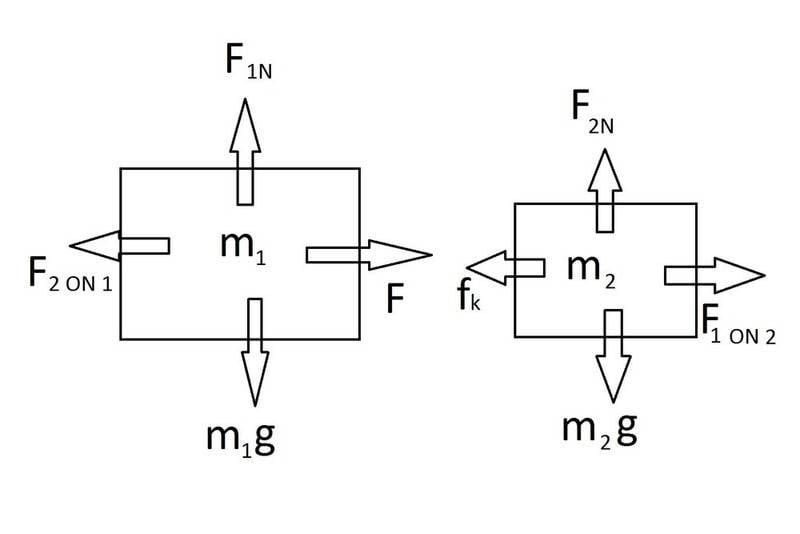

Thank You for the response. At the moment, we're ignoring rolling friction. The question had a hint, "only one of the objects experiences the friction force". So I assumed, the kinetic friction is only applied to object 2. However, I feel like I'm missing something on my free body diagram for object 1.
Also, there is a force, F, being applied to object 1, and object 1 is pushing against object 2. So, if m1a = F - F2 ON 1 is true, is the force F on object 1, related to the action-reaction forces?

The acceleration should be the same for both objects.
a = m1/(F - F2 ON 1)
a = m2/(F1 ON 2 - fk)
So F = (m1(F1 ON 2 - fk)/m2) + F2 ON 1
These equations are derived from my diagram. So is my diagram correct? Ignoring rolling friction.

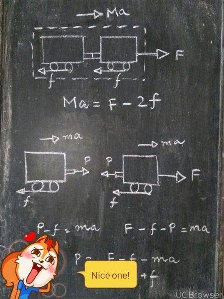

Sorry Brother,
I could not send the picture in previous answer.
Here it is

Oh so, friction is applied to each individual system? For instance, if rolling friction is ignored, there would be no friction force on object 1, and the kinetic friction would be only present for object 2? If both objects were treated as one system, the friction force on the system would essentially be the kinetic friction from object 2 alone?

The free body diagrams are fine.

No, actually in the picture I considered Both the Frictional Resisting forces to be same as f .
But if you take individual Free Bodies and Ignore Rolling Friction, then there will be No Friction Force on the Object with Wheels in its FBD.

for object 2: F1 on 2 = fk
I am not sure why you believe this. It is not correct. ##f_k## is the friction force and is proportional to the normal force. It does not have any particular relationship to ##F_{1on2}##

I dislike this approach and prefer to use an inertial frame, but regardless of whether you use an inertial or a non inertial frame you never get ##f_k=F_{1on2}##
Dale said:
@Ehden, your diagrams are correct. I do hope that you do not get confused from this thread.
