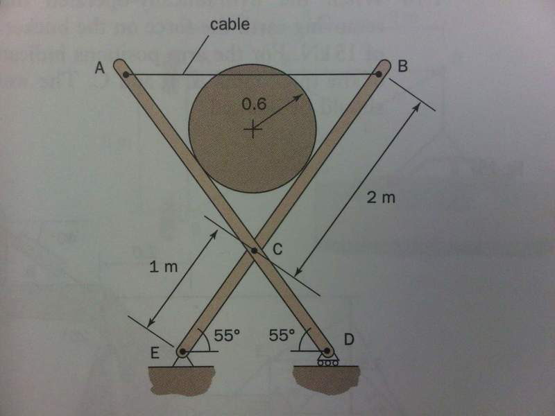

Hi,

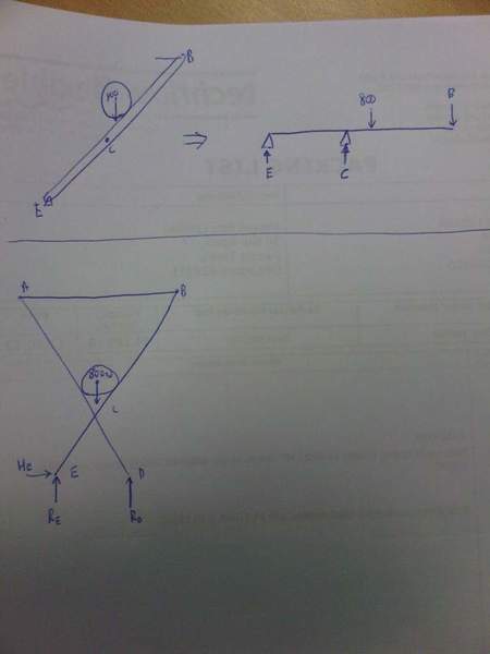

When looking at a photo or sketch, I find it hard to take out the important bits and turn it into a freebody diagram. I am doing this question (pic attached).
Im quite unsure how to even begin. I've though of a few ways to start analysing it.
The first way analyses AD as a whole. And essentially all the forces would produce a moment about C.
the bottom pic shows the forces (the ball exerts 800N) and I would calculate the reactions in the supports. I would be tempted to find the reactions then put them back into the analysis mentioned above (moments about C). The only prob is, I am not sure its as easy as saying ƩF(y)=0. ∴Reaction(D) = Reaction(E) = -400N.
Are there any pointers? I do have the solutions manual however Id just like a nudge in the right direction before taking a peek. Thanks.

When you look as the system as a whole, yes, the reactions at E and D must be vertical upward and equal, at 400 N each, assuming the ball weighs 800 N (does it?). You can sum moments about E = 0 to find the upward reaction at D, and then use your sum of forces = 0 in y direction to find the upward reaction at E, to get this result. You should also sum forces in the x direction to solve for any horizontal force at E, if there is one (is there?).
Then when you try to find the other forces at joints A, B, and C, you can break apart one of the members as you have done (but show it as a diagonal as it it exists, don't flatten it out), and sum moments about C to get B, etc. However, if the ball weighs 800 N, the vertical force from the sphere is not 800 N in this FBD..what should it be?

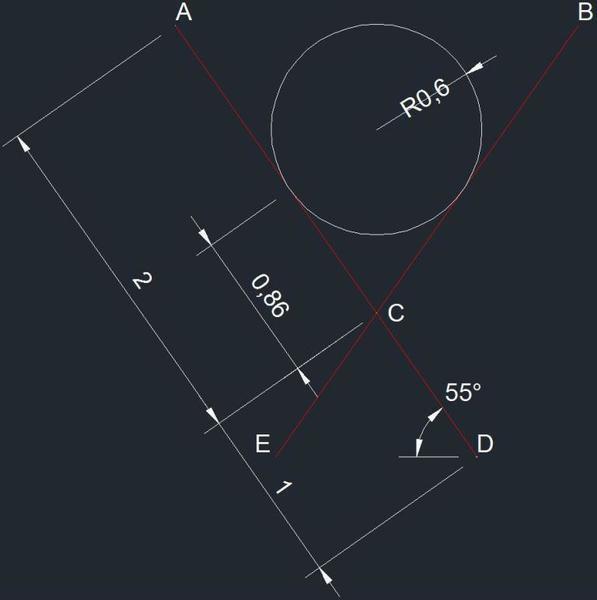

I see the reactions are 400N = R(e) = R(d) and there are no horizontal reactions. What I have been doing is resolving parallel and perpendicular to the plane.
I will try your method of taking moments about C. I would love to see a mathmatical way of finding out the distance between C and the point of contact of the ball and member. I've forgotton too much maths to do it myself, so I employed some CAD help (pic attached).
The distance is 0.86m, so now I will resolve the forces perpendicular to the member and take moments about C, i.e.
(1)400cos55 + (0.86)800cos55 = (2)F[itex]_{AB}[/itex]sin55
Rearranging F[itex]_{AB}[/itex] = 230+395/(2sin55) = 381N
This is not the answer in the back of the book, I must be missing somthing.
you're a lot better at CAD than I, so I'll take your word that 0.86 m is correct, since I'm also pretty bad at geometry
Almost correct, but not quite...that middle term (0.86)800cos55 is incorrect...its that 800 number that is wrong...part of the ball's weight is on the other member...so that 800 number should instead be ___?___. Otherwise, this is real good.
Thanks for the guidance. I now have the answer. Due to symmetry and resolving vertically I arrived at 800=2Rcos55 where R is the perpendicular force exerted on 1 member and equals 697N.
