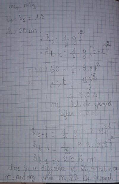

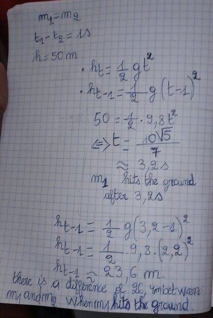

From a height of 50 meters two heavy masses are dropped at 1s interval.
They ask how high the second masses is when the first hits the ground
I don't even know where to begin. I assume that the masses are equal.

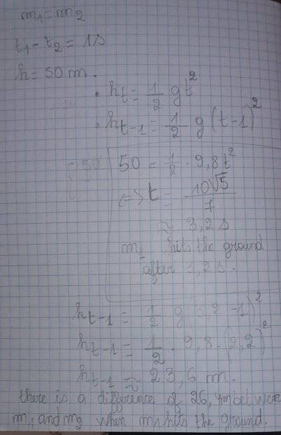

New poster has been reminded not to post illegible images of their work
This it what i found
If I could read it I might be able to answer that :rolleyes:

A dummy progression said:
Is it correct?
Is that ##26.4m##?
But it seems you do know where to begin and you do know to find your way through this exercise, so not all is lost !
:welcome: !
Teaser: what if ##m_2 = 2 m_1 ## ?
You have got the right answer, but I don't understand your method. If the initial height is ##h_0 = 50m##, then, for mass ##m_1##:$$h = h_0 -\frac 1 2 gt^2$$
Thanks for the method. It is way simpler.
Oh well, at least it's legible now. Much better than what I achieved with my expensive image enhancement software :wink: .
So ##h_t## is not the height at time ##t##, but the distance over which ##m ## has fallen in time ##t## . Fine with me, but easily confusing, which may be disastrous later on.
So it's good you approve of Perok's approach.
And you didn't answer my teaser !

Give me some time for the teaser. I am putting the homework on paper.
Let me save you some time: do you see an ##m## anywhere in the calculations to get the answer ?
:biggrin:

No, and i think that the m is of no use
Newton's law of gravity says that the force between two masses is proportion to the product of their masses. If ##M## is the mass of the Earth, and ##R## is the radius of the Earth, then the gravitational force on an object of mass ##m## on the surface of the Earth has magnitude:$$F_g = \frac{GMm}{R^2}$$Where ##G## is the universal gravitational constant.
Also, Newton's second law says that the acceleration of a body of mass ##m## subject to a force of magnitude ##F## is given by:$$a = \frac F m$$Putting these two laws together we see that the acceleration of a body at the surface of the Earth is independent of its mass:$$g = \frac{F_g}{m} =\frac{GM}{R^2} \approx 9.8m/s^2 \ \ (1)$$This is why in free fall problems we can omit the masses and forces and skip directly to the equation $$y = y_0 + u_yt - \frac 1 2 gt^2$$Where I've taken upwards to be positive, hence ##a = -g##.
If we were dealing with an electromangentic force on a particle of change ##q## and mass ##m## then we would have to take both the charge and mass of the particle into account (as well as the EM field strength) in order to calculate the acceleration.
Note that equation (1) holds approximately for anywhere near the surface of the Earth. It doesn't hold for problems involving satellites or the Moon or any motion that is sufficiently far from the Earth's surface. For any problem where the heights involved are no more than a few kilometres, you can assume that ##g## is approximately a constant of ##9.8m/s^2##.
