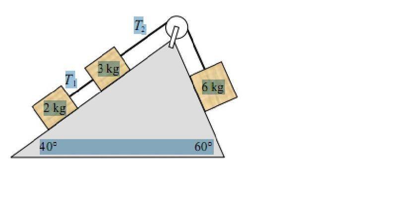

1. Three blocks are tied to each other with
two pieces of string, one of which
passes over a frictionless pulley, as
shown. The coefficient of friction
between each block and the surface on
which it slides is 0.2. Just as the
system starts to move, the 3 kg and
6 kg blocks are each one metre away
from the pulley.
1.1Determine the tension in each of the strings.
1.2 How long before one of the blocks jams the pulley?
