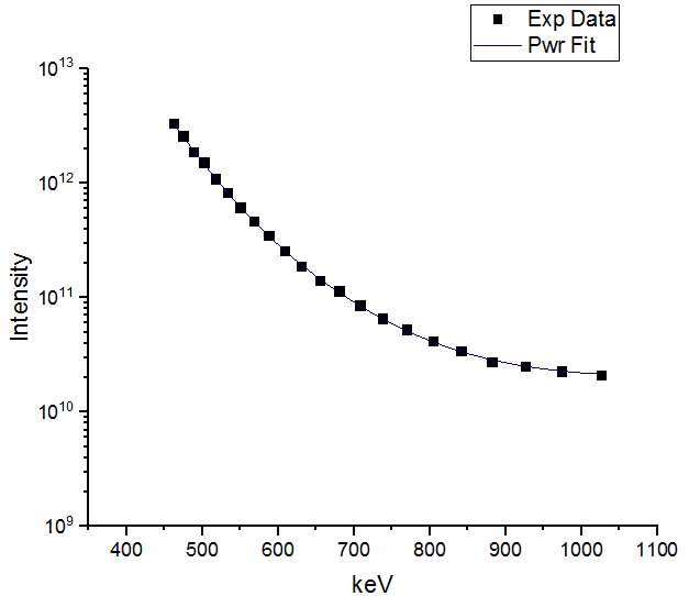

Log-log plot of Intensity against keV from about 460 to 1030 keV, with a power-law fit curve through experimental data points that decrease steadily from about 3e12 to 2e10.

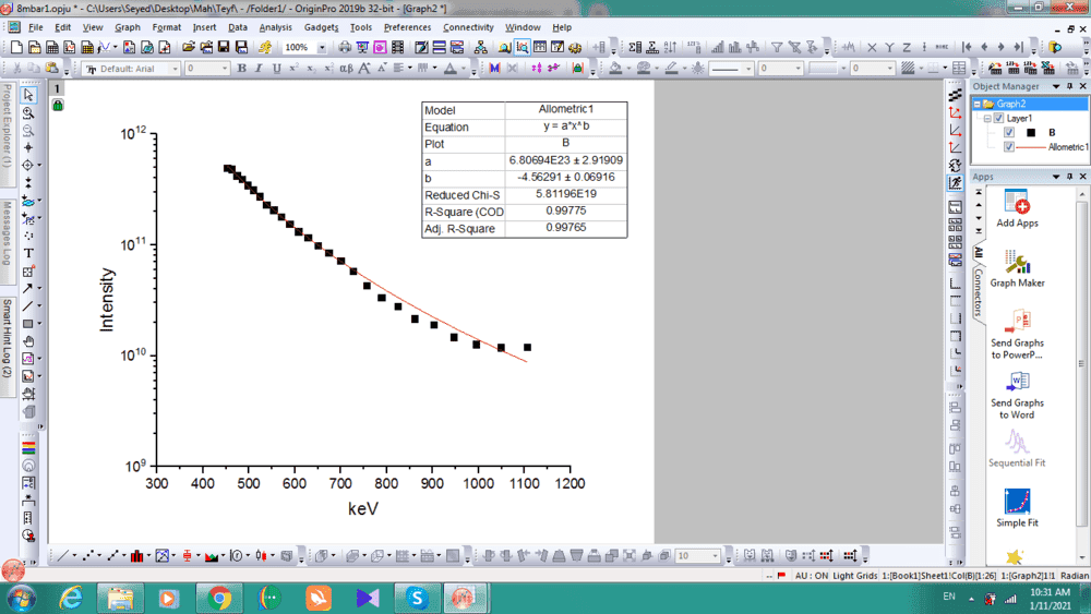

1. yes y is the number of ions.
2. n=4
3. the difference is the gas pressure in which the capacitor discharges:
at 6mbar the spectrum fits with exp
at 10mbar it's a power fit

The "power fit" graph you posted is log-linear, so is y in the power equation the number of ions (intensity?) or the log of the number?
And does this mean your exponential graph is also after taking logs, so you really have log(intensity) is negative exponential?!

1. it's been plotted in log format, y is number only not log
2. 3.8<n<4.1

Why would you plot it log-linear if trying to demonstrate a power law fit? Plot y-y0 log-log against x, or plot y-y0 against ##x^{-4}##.

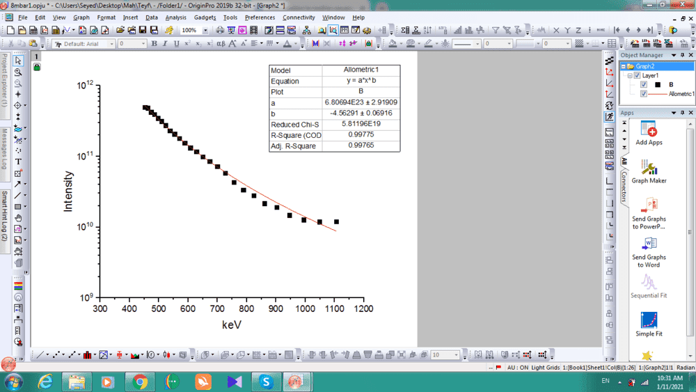

This data and many others fit well with power law without any curve at the end.
However what I want to know is that if we have power law and exponential equations (as stated in post #39) how we can assign a potential function to them? This is what we need to present to the class! Please help on this.
Thanks

Do you mean a power law or a polynomial?

I assume the two columns in the data you posted are respectively x, y.
I just tried plotting y against x-4. Nothing like a straight line.
Please post exactly what power law equation (constants included) you get for the relationship.

This is another plot with power law fit in origin for the same device:
##Y=KX^{-n}## where ##K=6.8*10^{23}## and ##n=4.56##
OriginPro screenshot of a log-log scatter plot of Intensity against keV with a red allometric power-law fit curve; fit box shows a = 6.80694E23, b = -4.56291.
I need the raw data and the power law equation you believe fits it for the same data.
The fit above doesn't look that great to me.

power law was mentioned above and the data is:
1106.16 1.20E+10
1048.02 1.19E+10
994.96 1.27E+10
946.43 1.48E+10
901.95 1.92E+10
861.07 2.17E+10
823.44 2.79E+10
788.72 3.35E+10
756.65 4.31E+10
726.96 5.83E+10
699.44 7.19E+10
673.89 8.53E+10
650.14 9.91E+10
628.04 1.17E+11
607.45 1.32E+11
588.24 1.54E+11
570.31 1.79E+11
553.55 2.07E+11
537.87 2.30E+11
523.20 2.74E+11
509.46 3.13E+11
496.58 3.45E+11
484.51 3.91E+11
473.18 4.23E+11
462.54 4.83E+11
452.56 4.94E+11

Is this the data that goes with the equation in post #55?
Yes.
