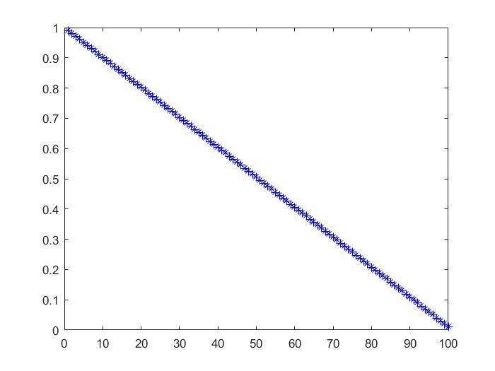

I thought about that, but decided to take a leap of faith and take tau = 1.
With tau = 1, then a 100 x 100 matrix presents me with 99,01% chance of ultimately ruining my opponent, as expected.
I present a plot of U(l) versus position l.

I am not sure you are grasping my point.
Suppose I wanted an equation for the speed of a car and came up with (engine rpm)x(gear ratio)x(wheel radius)x(some constant)/(number of steering wheels). Setting the number of steering wheels to 1 may give the right answer, but that does not mean it is the right value to plug in. The number of steering wheels should not have featured in the equation in the first place.

I see your point.

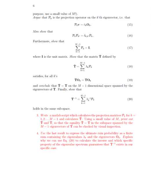

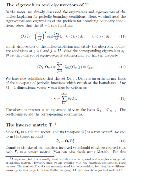

We have that O(j) for k = 1.. M-1 is a column matrix, but does this imply that O(j) is a row vector with matrix elements (k,j)=(1,1), (1,2), (1,3), (1,4)?
