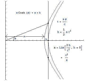

[tex] \begin{center}<br /> \begin{tabular}{| c | c | c | c| }<br /> \hline<br /> Formula & <br /> ind. vars & <br /> name & <br /> derivation \\ \hline<br /> <br /> r_m=\frac {GM_{conv}}{c^2} & <br /> M_{conv} & <br /> Geometric Mass & <br /> .5*Schwartzchild Radius \\ \hline<br /> <br /> <br /> r_c=\frac{c^2}{a} &<br /> a &<br /> Rindler Horizon &<br /> position of stationary event in accelerating frame \\ \hline<br /> <br /> r_c= \frac {c^2 r^2} {G M} & <br /> M, r & <br /> spatial curvature & <br /> Rindler Horizon with Newtonian Gravity \\ \hline<br /> <br /> r_c=\frac{s^2}{8 h} &<br /> s,h &<br /> radius of curvature &<br /> See attached diagram \\ \hline<br /> <br /> -(1+ c^2g00) & <br /> ? & <br /> time curvature & <br /> ? \\ \hline<br /> <br /> g_{tt}=1-\frac{2 G M_{conv}} {c^2 r} & M_{conv}, r & (grav time dilation)^2 & ? \\ \hline<br /> g_{tt}=1-\frac{2 U} {c^2} & U \in \lbrace - \infty , 0 \rbrace & (grav time dilation)^2 & ? \\ \hline<br /> <br /> <br /> \end{tabular}<br /> \end{center}[/tex]​

I am just applying some corrections and additions to the table based on your responses. I fixed the Sch. radius and added equations for gtt.
I also attached a diagram related to your calculation of s2/8h. I was thinking that the s was the space-time-interval, but that is definitely not the case in this diagram. Or if it is the case, it is only because [itex](ct)^2 - h^2 \approx (ct)^2+h^2[/itex] for this low-velocity case.

JDoolin said:
I...added equations for gtt.
The second equation for [itex]g_{tt}[/itex] should have a plus sign in front of the U term; the term only becomes negative because the sign of U itself is negative (as you note in the table).
The diagram as you've drawn it is backwards; the "radius" lines should go to the center of the circle.
In the diagram, of course, "s" is just a distance, as you note; but in MTW, "s" does refer to a spacetime interval (which is basically just the time interval, since it's so much larger than the space interval--here both "intervals" refer to the horizontal travel of the ball or the bullet, so the "time interval" is c times the travel time, 2 sec or 0.02 sec, and the "space interval" is just 10 meters in both cases; h only comes in when we apply the formula for radius of curvature). That's why I said the MTW argument was basically hand-waving.
  • #43
Are you sure? The equation now has it so the gravitational time dilation is 1 when you are far away from any masses, and it increases toward infinity as you go into the black hole. The way you're saying, it would go to zero fairly quickly, (so time would be speed up in the gravitational well) and then tend toward negative infinity.

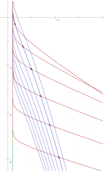

I made a new diagram.
Code:
c = 3*10^8; a = 9.8;
xmin = -c^2/a;
xmax = 5 c^2/a;
tbound = 3 c/a;
p1 = ContourPlot[(x + c^2/a)^2 - (c*t)^2 == c^4/a^2, {x, xmin,
    xmax}, {t, -tbound, tbound}, Axes -> True];(*hyperbolic*)
p2 = ContourPlot[x == a/2 t^2, {x, xmin, xmax}, {t, -tbound, tbound},
   Axes -> True];(*quadratic*)
p3 = ContourPlot[
   x + c^2/a == c t, {x, xmin, xmax}, {t, -tbound, tbound}];(*linear*)
