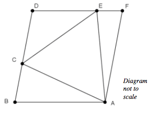

As shown in the diagram (attached), ABDF is a rhombus, ACE is an equilateral triangle, and AB  AC . Find ABC through geometric reasoning (a scale diagram will gain no credit).
2. See drawing (picture attached)
If I make angle ABC = x then BCA is also = x (as triangle ABC is isosceles) so I got x + x + 180 - 2x = 180
angles ACE = CEA = EAC = 60 degrees (Equilateral triangle)
Must I use alternate angles to help me solve this problem...
You need to find some way to use that ABDF is a rhombus, not just a parallelogram.
if BCA = x then CAF = x (alternate angles)
CAE = 60 but what is EAF = ?
What has that to do with my hint? What is the difference between a rhombus and a general parallelogram?
sides are equal
how does that help me?
Is BC a 1/3 of BD?
Maybe more isosceles triangles?
So we have ABC = BDF = DFA = x
No, BDF is not equal to the other two.
You need to use that it is a rhombus, not just a parallelogram. Find two sides that are equal in the rhombus but might not be in a parallelogram.
So ABC = DFA = x
in each triangle we get x + x + 180 - 2x = 180 (but then this is obvious)
Natasha1 said:
So ABC = DFA = x
I repeat:
In quadrilateral CEFA we have 60+x+x+180-2x+60+60=360 but then 360 = 360 leads nowhere
all 4 sides are equal in a rhombus
Yes, but some are also equal in a parallelogram. I repeat
i give up
Natasha1 said:
i give up
As you said, all four sides are equal in a rhombus. That is not true of a parallelogram. In a parallelogram, which sides must be equal? Which sides need not be equal? Answer in terms of 'adjacent' and 'opposite'.
Opposite
Natasha1 said:
Opposite
Which question is that the answer to? I asked which must be equal and which need not be equal. The answers are different, obviously.
In the rhombus ABDF, AB = BD = DF = FA
In a parallelogram opposite = equal, adjacent = not equal
is x = 30 degrees? (a guess)
How can knowing that triangles ABC and AFE are isosceles and similar help me in finding angle ABC?
Right, so pick some pair of adjacent sides.. AB and BD say. You know these are equal. What isosceles triangle does that give you?
similar isosceles triangles
I mean with reference to the points in the diagram. Choose two adjacent sides of the rhombus and say which you have chosen. You know they are equal length, so they form two sides of an isosceles triangle. Which triangle? What angles are therefore equal?
