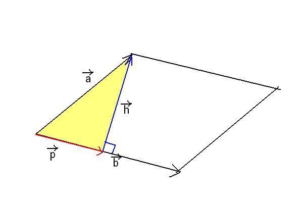

Find the coordinates of the vector of the height of the parallelogram formed by vectors a={1, 2, 1} and b={2, -1, 0}
A=|axb|, A=|a|*h
I can find the intensity of the vector h i.e the length of the height, but not its vector. I know the dot product of a and h is zero, but that's it. I'm stuck.
##\vec p## is the projection of ##\vec a## onto the direction of ##\vec b## , and ##\vec h = \vec a - \vec p ##
