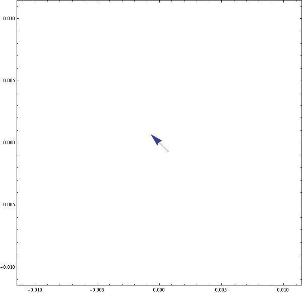

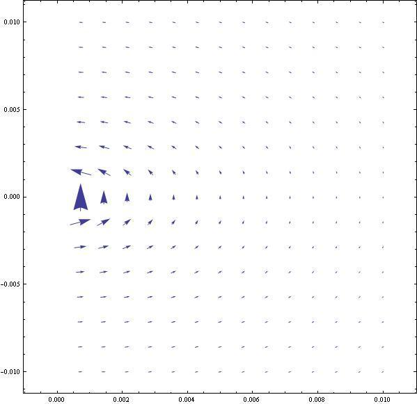

But I still have my original problem: That when I plot B using these for negative x, then I don't see the correct magnetic field. I thought that I was perhaps missing a term [itex]\pi/2[/itex], but that didn't solve it either.
What do you get and what is your expectation?
I have attached a plot of what I see (the axes are (x, y), the current 1A and the units on the axis in meters), it is called "negative_x". If I only plot for positive x-values I get "positive_x", and there I see what I expect (as shown here, on the top: http://www.netdenizen.com/emagnet/solenoids/frommaxwellonly.htm).

You should be able to simply the formula very significantly. Note that ## \frac 1 {\sqrt {1 + y^2/x^2}} = \frac x {\sqrt {x^2 + y^2}} ##, and the radical in the denominator nicely couples with that in the common factor. But even then your formula is not wrong, I am not sure why Mathematica does not plot it correctly.
I don't know either. Strange, but nice to know that I have the correct exprssion. Thanks!

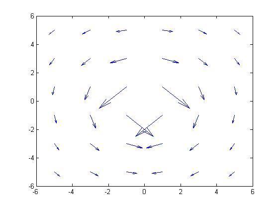

OK, I just plotted it in MatLAB, and it *isn't* correct. For x<0 the y-coordinates all have to change sign. So the expression is not correct.
EDIT: I have attached the plot.

Your formula is ## (\mu_0/2 \pi)
I \frac 1 {(x^2 + y^2)^{1/2}} \left(\frac {-y/x } {(1 + y^2/x^2)^{1/2}},
\frac 1 {(1 + y^2/x^2)^{1/2}} \right)##
Observe that the y-component is always positive, which is incorrect. If you transform it the way I suggested, you will get ## (\mu_0/2 \pi) I \frac 1 {x^2 + y^2} \left(-y, x\right)##, which restores the correct sign.
