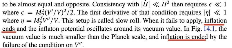

How to determine whether a cosmological inflation model (say single-field slow-roll inflation) gracefully exit or not? Is it like showing that inflation is ending at some value of inflaton?

Are you saying that violation of conditions ε, η≈1 can be called a graceful exit of inflation (slow roll)? Is it sufficient?

I've spent a bit more time and read the pages in the book again. Actually, there is a risk that the conditions described in the appendix are just necessary conditions. Lyth does seem to refer to the entire proposed shape of the inflaton potential (fig 14.1 in the book) as being required to guarantee an exit from inflation.
Your original post seemed to ask for criteria to determine if inflation has ended and/or if (the usual model of) the inflaton field provides a graceful exit from inflation. Lyth's book describes this. So I hope that wasn't a waste of your time.
Your second post suggests that you might be trying to develop a whole new shape for the inflaton potential and wanted some sufficient conditions to check this will give you a graceful exit from inflation. That's quite different thing and I don't think Lyth's book will help much with that, sorry.
