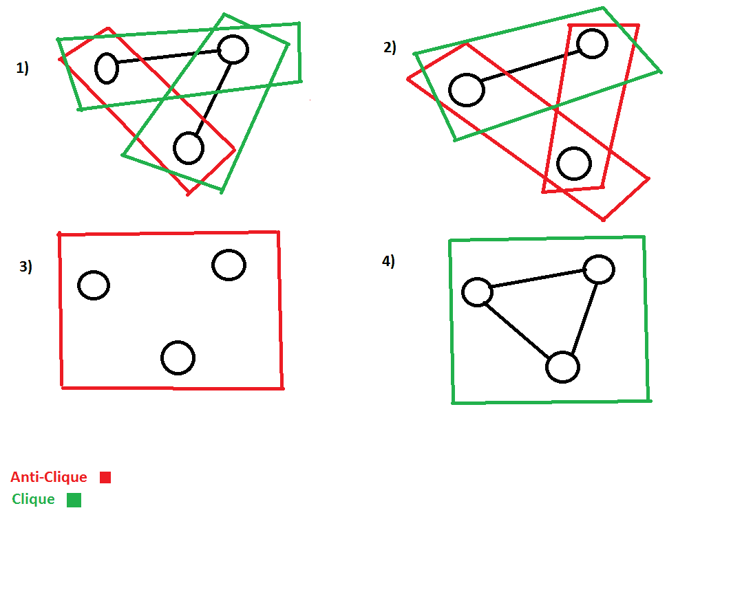

When we have graphs with $3$ nodes:
doesn't the graphs have cliques or anti-cliques with at least $2$ nodes??
But $\frac{1}{2} \log_2 3=0.7924 \dots $. So have I done something wrong?? (Wondering)

In your example, $R(2,2) = 2$, in other words, any graph that has $2$ or more vertices, you are going to find a $2$-clique or $2$-independent set. But that's not what the actual statement you want to prove. In the case $\nu = 3$,
the statement in fact promises a $0$-clique or a $0$-independent set, which is vacuously true.
