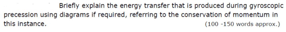

Hello,
I have this i am learning. I have been trying to find information online but have struggled to find anything which helps me. YouTube usually has good videos, but doesn't seem to on this. This is one topic i have never learned before. But keen to.
I was hoping someone could help me complete this, or point me in the right direction please.
I am stuck on determine the mass of the wheel. Possibly some simpe way to do this, but my mind is just blank. Once i have calculated this, i am hoping the next step i will be able to figure out.
Thank you.

Now i have finished the rest of the question.
Angular Momentum:
$$L = I \cdot w$$
$$I = 3.55kgm^2$$
$$w = 27Rad/s$$
$$ L = 3.55kgm^2 \cdot 27Rad/s$$
$$ L = 9.85kgm^2/s$$
Torque in Axle:
$$Torque = mgl$$
$$Torque = 9.86kg \cdot 9.81m/s \cdot0.12m$$
$$Torque = 11.6N$$
Explain energy transfer that is produced during gyroscopic procession. Referring to the conservation of momentum in this instance:
When the torque is applied, then the torque is topped. The angular momentum of the system can not change. This is because their is no torque on the system. Spin angular momentum will always move in the direction of the torque.
When torque is applied to a wheel. We get procession. Conservation of angular momentum will always be maintained as long as we have no net torque acting on the object.
Are these correct?
I though i would do the writing to ensure i understand.
If not where have i gone wrong?
Thank you.

(1) the torque of 4 Nm is applied until the 27 rad/s is reached -- if is that the one you mean with 'is topped' then I agree.
'When the torque is applied ' -- you mean when the support on the free end of the axle is removed (as in the videos). The description in the exercise text is a bit vague, but my perception is that you are supposed to read it that way (otherwise it really gets much too complicated)
I don't know what to do with
Since ##\tau \perp \omega##, the 11.6 Nm only changes the direction of ##\omega,\ ## I would think no energy transfer occurs, but that sure doesn't feel good: where does the energy for the rotation about a vertical axis come from ? A decrease in ##\omega##, a slight drop of the free end of the axle ?
Pehaps @etotheipi has a suggestion ?
I think you are right; for such an idealised gyroscope, the kinetic energy is constant. If ##\omega_p## is the precession angular velocity and ##\omega_s## is the spin angular velocity of the wheel, then by the König theorem the total kinetic energy is $$T = \frac{1}{2}Md^2 {\omega_p}^2 + \frac{1}{2}I_{wheel}{\omega_s}^2$$I'll finish off the analysis I started earlier,$$\vec{\tau} = \vec{r} \times M\vec{g} = (Mgd)\hat{\theta} = \frac{d\vec{L}}{dt} = \frac{d}{dt} \left(Md^2 \omega_p \hat{z} + I_{cm}\omega_s \hat{r} \right) = I_{cm} \omega_s \omega_p \hat{\theta}$$ $$\omega_p = \frac{Mgd}{I_{cm}\omega_s}$$so with constant spin angular velocity ##\omega_s##, we also have constant ##\omega_p##.
