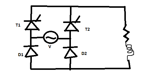

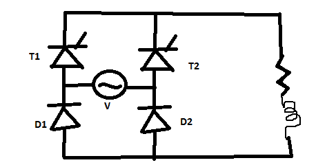

A half controlled single bridge rectifier is supplying an R-L load. It is operated at firing angle 'alpha'. Load current is continous. What is fraction of cycle that the freewheeling diode conducts?
Circuit schematic of a half-controlled single-phase bridge rectifier with thyristors T1 and T2 and diodes D1 and D2, an AC source V across the centre, and an R-L load on the right.
Well I guess each diode will conduct for half the cycle like from 0 to pie and then from pie to 2 pie, the other diode will conduct.
So the answer must be 1/2. But book answer is alpha / pie.[/B]

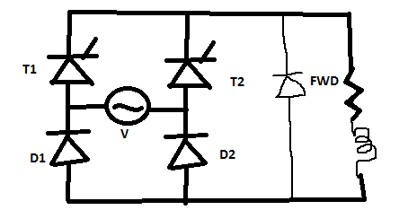

None of the 4 devices shown in your OP is a free-wheeling diode. Why is there no such diode shown in a question that apparently refers to it? :oldconfused:

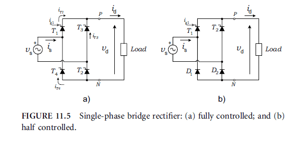

I thought FWD are the diodes D1 and D2. As per first diagram in the link:
http://www.technik-emden.de/~elmalab/projekte/ws9899/pe_html/ch06s1/ch06s1p1.htm
and book diagram:
Two circuit schematics of single-phase bridge rectifiers, labelled a) fully controlled with thyristors T1 to T4 and b) half controlled with thyristors T1 and T2 plus diodes D1 and D2, both feeding a load between terminals P and N.
So it's a diode parallel to RL load with anode of diode towards up and cathode facing down.
Thanks.
If load current is continuous, then the diodes in the rectifier must share conduction equally and your original answer would have to be right.
There is "freewheeling" operation due to the load inductance, otherwise load current could not be continuous. But I am not sure whether the 2 diodes that form half of the bridge are usually referred to as freewheeling diodes, though. I'll have to look at this more closely.
It's the diode directly across the load that I think of as the classic freewheeling diode.

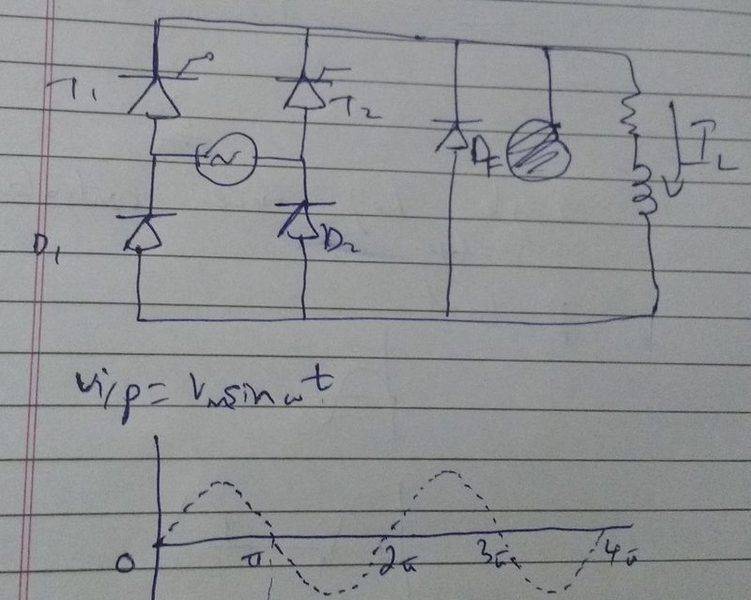

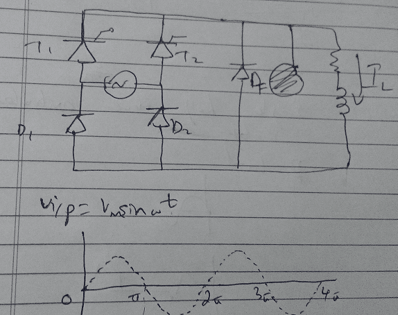

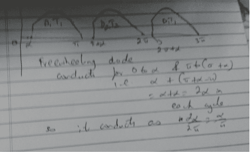

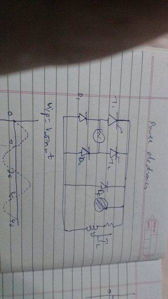

I tried with ur concept of FWD and got this answer as:
Hand-drawn circuit of a half-controlled single-phase bridge rectifier with thyristors T1 and T2, diodes D1, D2 and a freewheeling diode D_f, an AC source, a load with inductor and load voltage V_L, and below it the input v_i/p = V_m sin wt waveform with firing angle alpha marked at multiples of pi.
Handwritten notes on lined paper showing a half-controlled rectifier waveform with thyristor conduction intervals marked, and text reading freewheeling diode conducts for 0 to alpha and pi+alpha to 2pi, giving alpha/pi per cycle.
Thus i get the book answer.

But i like first explanation of mine better where ur concept of FWD is used. Thanks..
