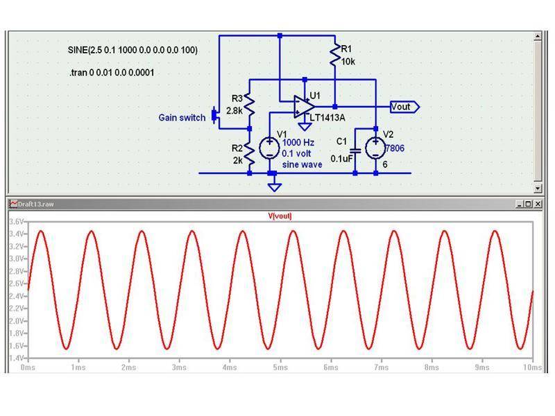

Hi-
What I present here (in thumbnail) is an amplifier circuit that interfaces between the Hall Effect sensor and the module input. The amplifier can be run with a gain of one, or a gain of 9.5.
The amplifier shown is the Linear LT1413, which is the same as the National LM358. The power supply is the 7806 (6 volts out).
V1 represents (simulates) the Hall Effect sensor output with a 2.5 volt quiescent dc offset and a 0.1 volt peak, 1000Hz sine wave. For a gain of one, all you need is the 10k (R1) from the LM358 output back to the (-) input. The simulation shows two more resistors, R2 and R3 (2k and 2.8k) with the ratio chosen such that the midpoint voltage (between R2 and R3) out is also 2.5 volts. If the (-) input is also tied the the R2 R3 midpoint via the gain switch (as shown), the amplifier gain is about 9.5, which is shown in the simulation. Do NOT put a capacitor from the midpoint to ground, as R2 and R3 are part of the feedback gain circuit.
If you need the gain, you may have to use a potentiometer to tweak the R2 R3 midpoint voltage to get a 2.5 volt quiescent voltage out.
Bob S

Wow thank you again for the input. I think this info is way over my head as I have very little knowledge of this sort of thing but I will try to figure it out.
Btw, does the above info take into consideration the info I gave in my previous post (#17)?
Yes. The circuit I show in the previous post has a voltage output Vout between ~ 0 volts and ~ 5 to 6 volts. The current drawn from the input module will be ~ 1.03 mA x (5- Vout)/5, which is just like a resistance load on the Hi-Hat sensor.

You're a good man. By the way, I followed your suggestion for the Linear opamp to their website and was able to get a few of the LT1413's sent out as samples.
It would probably be much easier to just use a slider pot for this project or even a soft pot has shown lots of promise as the slider pots wear out after just a few months. But the hall sensor seems ideal for this application; its interesting that it has been overlooked thus far.
I'll probably put a small pot in the circuit as you suggeseted for the gain to give better resolution on tuning the sensitivity.
