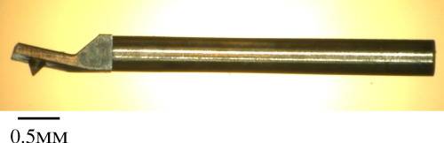

If you are still thinking about carbide, you could get one of these brazed-carbide lathe tools cheap. The cutting part (the carbide) is the grey sort of semi-circular part at the far left in the photo. The carbide is usually about 1/4 inch wide and maybe 3/8 long. This one is chipped, if you lived nearby I'd give it to you. If you know anyone into home shop machining I'm sure they have discards like this.
Thanks. I'm still thinking about carbide, along with all the other suggestions that everyone has made! I was starting to give up on cutting blades though as most of the ones I've seen online have only been carbide tipped. This seems different :) And I do know someone that might have something like that!
