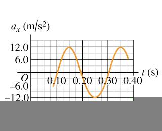

On a frictionless, horizontal air track, a glider oscillates at the end of an ideal spring of force constant 2.20 N/cm . The graph in the figure shows the acceleration of the glider as a function of time.
Find the mass of the glider.
T= 2pi\sqrt{m/C}
2.2 N/cm = 220 N/m
C=220
.4 = 2pi\sqrt{m/220}
m = 1389
I know I'm doing something wrong but what?
How much is the period of the sine wave ?
would it be .2s? when it passes back through O and to where it started?
I tried .2 and .3. are any of these the right time for period? If so then my problem lies elsewhere. any insight? thanks
okay i see now. .10 is the time for a period.
so .10 = 2pi \sqrt{m/220}
multiply both sides by \sqrt{220}
1.48 = 2pi\sqrt{m}
divide both sides by 2pi
2.43 = \sqrt{m}
square both sides
m = 5.43 which is still the wrong answer.
is my math wrong? what exactly am i doing wrong?
