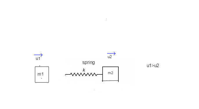

My teacher taught us conservation of momentum.She gave us an example (or way to think )as if one of the blocks has spring attached to it.As given in the image.As u1 >u2 there will be collision ,though surface is not shown it is assumed to be smooth so that friction does not act,this is necessary condition for external force to be zero and in turn for conservation of momentum.The block one will collide with block 2.So,in this process spring is compressed so in order to restore it's position it will apply force on both the blocks,force applied by spring on the left block would be in left direction and force applied by spring on the right block would be in right direction.So,left block which was having greater velocity will decelerate after collision and m2 will accelerate after collision.What I don't understand is why spring applies force on both the blocks to restore its position?Shouldn't it apply force only on m1 in left direction so that it comes to it's original position?
No, the spring will apply a force on both of them. A body that undergoes elastic compression pushes on all objects attached to it along the axis of compression.While I don't want you to do what's not recommended by your teacher, I would suggest that you don't take this "spring" idea too far in more complex problems. Your intuition might work against you (as was in this case).
A force is exerted on the wall as well.
The compressed string pushes both the masses.

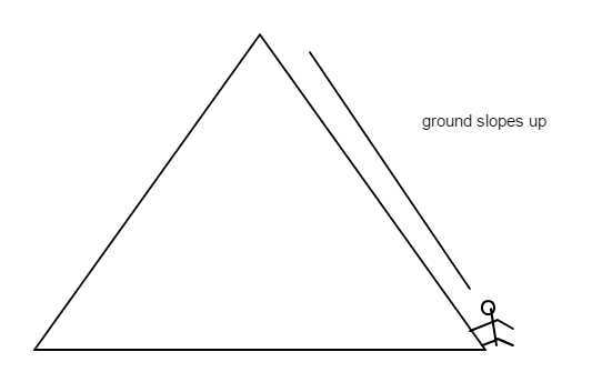

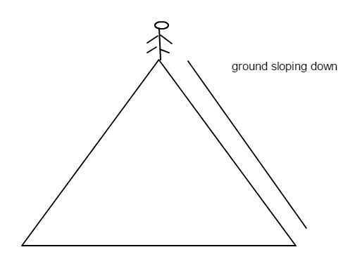

gracy said:
Sorry I have not taken maths.
See the edit to my prior post, if you are standing on the side of a hill where the ground slopes up, are you at the top?
No.I will be at at the top if I see ground sloping down.
if I am standing on the side of a hill where the ground slopes up,I am at the bottom most point.Right?

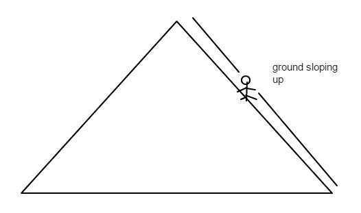

I think my picture of ground sloping up was not correct in my prior post.This one is correct.
Ok, good. We are making progress. The key point I wanted you to recognize is that if you are on the side of a hill where there is a slope, that you can climb higher yet. You are not at the top.
Now there is one feature of hills that is not reflected on your drawing -- they tend to be smooth. The tops will be rounded off and not pointy. If you are exactly at the top of a round hill can you see that the slope there must be zero?
[Edit: Can you at least see that it must be nearly zero so that we don't get into distracting quibbles about what it means to be exactly zero]
