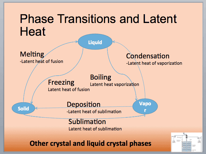

Would you have to do this any time there is a phase change?? No matter what direction, ie liquid to solid or solid to liquid and all the rest. Will the latent heat be given for each phase if there is one?
With a substance like water, the values of the latent heat can be looked up.
Remember, the latent heat of fusion ≠ latent heat of vaporization.

Yes, you have to take into account latent heat for any phase transition. Pay also attention to the sign of the change: for example, when going from solid to liquid, heat enters the substance without any change in temperature, while going from liquid to solid, heat is released from the substance without any change in temperature.
