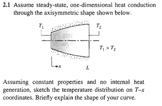

While revisiting Heat Transfer I stumbled upon a simple problem, that yet got me thinking.
It is as follows:

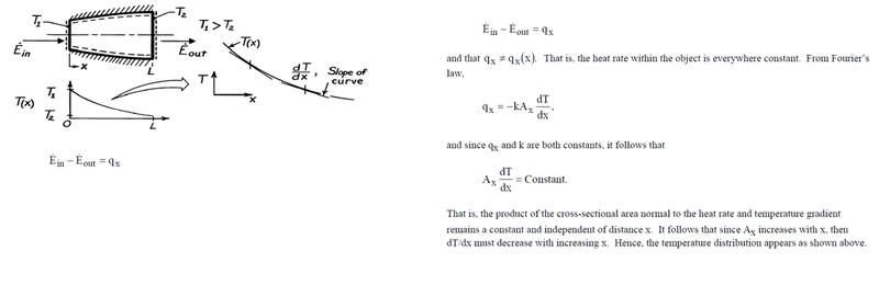

Before anything else, let me show you how they solve the problem:
Now, altough I understand and agree with their simple solution, I later tried to apply the heat equation to this problem:

The heat equation that you present is for one-dimensional heat conduction with constant cross-sectional area. You have to derive the heat equation for the more general case of non-constant cross-sectional area:
First consider the energy contained in a small volume with area A and thickness [itex]\Delta x[/itex]
[itex]E=e A \Delta x[/itex]
The change of energy E in time for the volume is 'what comes in minus what comes out'. The 'heat flow' is following Fourier law: [itex]q = -kT_x[/itex]
So the balance equation becomes:
[itex](e(x,t) A(x)\Delta x)_t = q(x,t)A(x) - q(x+\Delta x,t)A(x+\Delta x)[/itex]
Now divide by [itex]\Delta x[/itex] and take the limit [itex]\Delta x \rightarrow 0[/itex]
[itex]A(x)(e(x,t))_t = -(q(x,t)A(x))_x =-A(x)q_x(x,t) -q(x)A_x(x) [/itex]
When [itex]e=\rho cp T[/itex] then,
[itex]A(x)\rho cp T_t = (kT_xA(x))_x = A(x)kT_{xx} + kT_x A_x(x) [/itex]
In the steady case you then have:
[itex]A(x)T_{xx} + T_x A_x(x) = 0 [/itex]
so you are missing a term. Integrating twice leads to
[itex]T(x) = C_2\int\frac{1}{A(x)}dx+ C_1[/itex]

They stopped before evaluating the one-dimensional equation, saying that Ax( dT/dx ) must be constant, knowing that the area changes.
You evaluated the equation as simply one dimensional heat flow with no area change.
The problem is an execution of how flows other than one dimensional, can be analyzed and solved by using the simpler one dimensional Fourier law, with correct assumptions, rather than using the all inclusive three dimensional equation.
