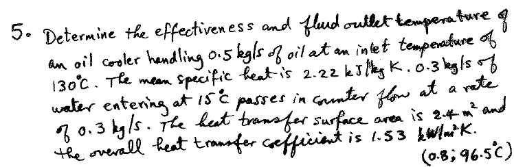

Dear All,
I am having trouble getting the effectiveness and outlet temperature for counter flow heat exchanger which is described in the attachment below.
I already have the answers but do not know what equations to use to get them. I have equations for the effectives and for the outlet temperatures, but there arn't enough variables from the question to put into them to get the correct answers.
Any advice on where to start would be great, thank you.
Answers to the question are shown on bottom right corner of attached picture. thanks for looking

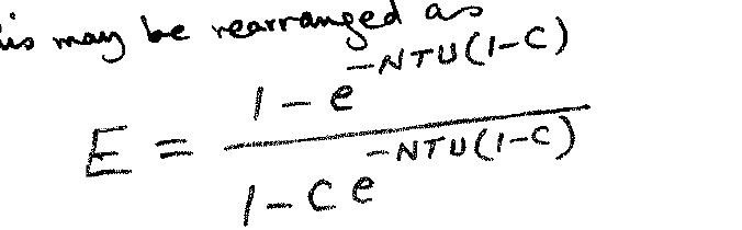

When I said 'I have equations' i meant i have a hand out of derived equations which might not be useful in their current form but i will try my best to give the ones i think are 'meant' to be used.
I will give the ones I wrote down on my note pad in class when i was clearly lost as to what was going on in that class:
Q=mc*Cpc*(Tc2-Tc1);
LMTD= (Outlet temp - inlet temp)/ (In(outlet temp/inlet temp));
mh*Cph > mc*Cpc;
NTU= (UA*A)/(mc*Cpc);
E =

mc = 0.3 kg/s (mass flow rate of cold fluid)
Cpc = specific heat of cold fluid?
Tc1= 15 degs C (Cold fluid inlet temp)
Tc2 = cold fluid outlet temp?
mh= 0.5 kg/s (mass flow rate hot fluid: oil)
Th1= 130 degs C (hot fluid inlet temp)
UA= 1.53 KW/ m^2 (overal heat transfer coefficient)
A= 2.4 m^2 (heat transfer surf. area)
Cp mean = 2.22 KJ/Kg KHope i haven't confused you more because i think i am.

You know the inlet temps. of the oil and the cooling water, but you have to find the outlet temps. This can be done by trial-and-error, or by using the so-called NTU method, which I believe you are supposed to use.
The following describes the NTU method:

I have all required variables to solve using NTU method except Cph and Cpc.
Is it possible to calculate this from the 'Cp mean' value of 2.22 KJ/Kg K?
If i can somehow get Cph and Cpc, I must be able to complete the other equations as these are the missing values.
Cph is going to be the spec. heat of the oil (Cph = spec. heat of the hot fluid)
Cpc is going to be the spec. heat of the cooling water (Cpc = spec.heat of the cold fluid)

Re-read Post #7 very carefully.
The mean Cp value for the oil is all you have for the 'hot' fluid.
You know that the 'cold' fluid is water. Don't you think the Cp of water can be obtained from a table of specific heats for various fluids?
Thank you very much, I can solve the problem now.

Different oils can have different spec. heats. Water, on the other hand, is the most common fluid on earth. There are tables of the properties of water readily available. IMO, you are supposed to determine the outlet temps. of both the water and the oil, since both are unknown.
