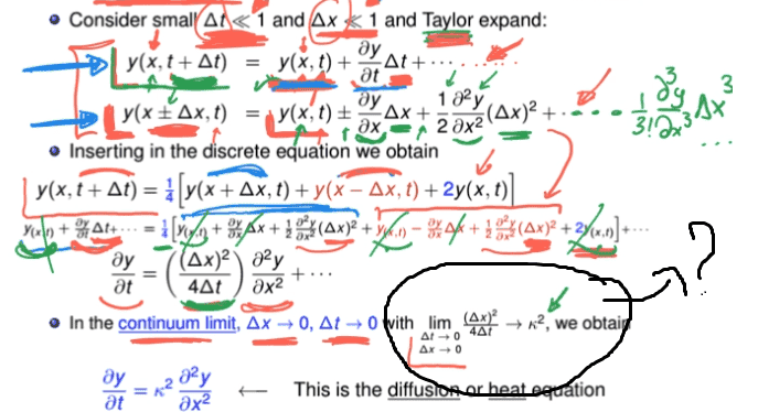

Hi Guys, I am trying to understand the derivation of the diffusion/heatwave equation, but I am stuck on how the person managed to get ##k^2##. I have attached the slide to this thread.
When the delta t and x approached zero, assumably it results in the whole fraction to be zero. The slide shows it will be ##k^2##. Can someone explain this to me, please?

Are you sure this isn't simply the definition of ##\kappa##? The limit is not negative, so you can define ##\kappa## to be the square root of it. It's a kappa, not k.

First of all , thank you for the instant reply! But I am still confused.. is that the mathematical definition for the ##\kappa##?
I think so. The limit is some value, you define ##\kappa## to be the square root of that limit, i.e. the limit is ##\kappa^2##.
