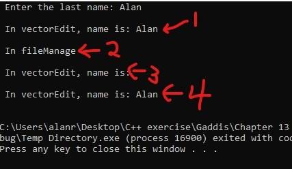

Hi Jarvis323
Thanks for the advice, it's a little late to change direction at this point as I think if I can fix the problem of DirV[] to the fileManage, the program should work. I know if I put file handling into vectorEdit.h, it should work with no problem.
I simplified the program to a few lines, I think the problem is the header files must have a different way of communicate. Obviously main() has no problem communicating with either header file to do things, but not between the two header files. Here is the short program:
main():
C++:
#include <iostream>
#include <cstring>
#include <vector>
#include "fileManage.h"
#include "vectorEdit.h"
using namespace std;
vectorClass vectC;
fileClass file;
int main()
{ count << " Enter the last name: "; cin >> vectC.Dir.lastName;
  count << endl;
  vectC.printName();
  file.goPrint();
  vectC.printName();
  return 0;
}//End main()
Here is the vectorEdit.h
C++:
#ifndef vectorEdit_H
#define vectorEdit_H
#include <vector>
#include <fstream>
#include <iomanip>
#include <iostream>
class vectorClass
  private:
    const static int nameLen = 25, phoneLen = 12;
  public:
    struct Directory
    {   char lastName[nameLen]; char firstName[nameLen];
        char phone[phoneLen]; int element;
    Directory  Dir;
    void printName()
    { std::count << " In vectorEdit, name is: " << Dir.lastName << "\n\n"; }
#endif
Here is the fileManage.h
C++:
#ifndef fileManage_H
#define fileManage_H
#include <vector>
#include <fstream>
#include <iostream>
//using namespace std;
class fileClass
{    public:
        vectorClass vectC;
        bool newF, failOpen;
        std::fstream file;
        void goPrint() { std::count << " In fileManage  " <<
            vectC.Dir.lastName << "\n\n"; vectC.printName(); }
};//End of fileClass
#endif
Here is the screen capture of the cmd:
1) main() calling member function printName() in vectorEdit.h. It works.
2) main() calling member function goPrint() in filemanage.h, it will NOT print "name is: Alan".
3) also in goPrint() it calls call printName() in vectorEdit.h Notice even calling the same printName(), it missed "Alan"
4) to confirm Dir still contain "Alan", main() call printName() one last time and it shows everything is there.Bottom line, fileManage.h cannot do anything on the data.
Am I just missing a little bit or it'll take a lot more to make this work. Obvious if it takes a lot more, I will just put the file handling back in vectorEdit.h, it's proven it will work as long as they are in the same header file. It is very clear this is way over my head.
Thanks for the advice.
  • #36
You have two vectorsClass objects, one in main, and another in the file object. They're different objects and an operation on one of them doesn't affect the other.
So you have to do something like remove the one in the file class, and pass in the one from main as an argument to the print function. Or delete the one in main and just operate on the one in the file object.
