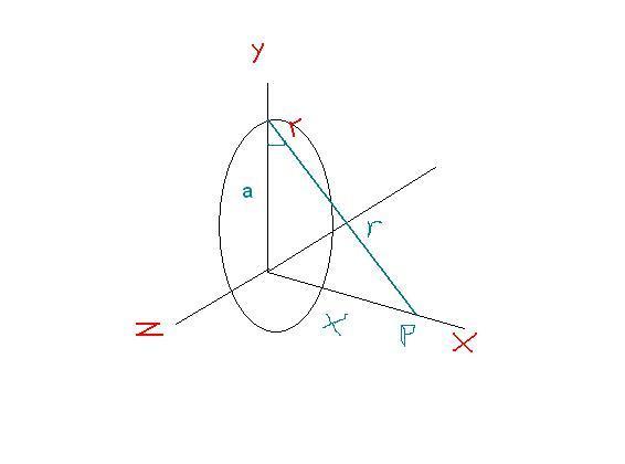

Hi, I have an exam monday and normally have no problems finding the components of integration, however in this one I don't know why but I do. Current is flowing in the loop in the direction shown, and a is the radius of the loop. The magnetic field from the y-components cancel out, so all that there is is the x component. To find the x component I thought it is \int dbx/r...but according to my textbook and an old exam it is \int dba/r...I have been trying to figure out the logic behind this but I cannot figure it out, we did a problem like this in class and the teacher did it my way...can someone help please?

mmmboh said:
… To find the x component I thought it is \int dbx/r...but according to my textbook and an old exam it is \int dba/r...
Hi mmmboh! :smile:
If it was an electric field, the field lines would go straight out, and E would be along r, so you would get the x-component by multiplying by x/r.
But the magnetic field has loopy field lines, and B is perpendicular to r, so the cosine is of the complementary angle, and is a/r. :wink:
