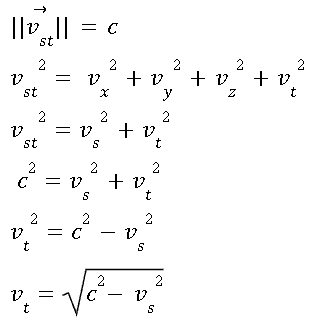

Help me determine whether this proof of time dilation formula is valid based on my understanding on ScienceClic's video
I recently trying to learn General Relativity by first scraping the surface on ScienceClic's general relativity playlist, and then I stumbled upon a video where it said that we actually move through spacetime on a constant speed of c, and then I remember about time dilation because how speed on space affect speed on time, here's my attempt on the derivation
We usually write velocity Magnitude as shown below, where Vs is V through space
In this video
at time stamp 1:11, they said we are all moving at a constant speed of light (c) in a spacetime coordinate. Where Vst is V through spacetime and Vt is V through time:
On our frame of reference, we don’t move through space is it not(?), only through time, so
When we see other frame of reference move through space, let say Vs’, we should see him move through time slower when compared to our frame of reference
is this kind of formula derivation valid?

"Deriving" the factoid is very simple: the invariant length of any timelike object's 4-velocity vector is ##c##. This is true by definition of 4-velocity. QED.
No. Spacetime is not Euclidean, and the 4-velocity vector is not a Euclidean vector whose squared magnitude is the sum of the squares of the components, as you are assuming.

The problem is that spacetime is not Euclidean, so writing ##c^2= v_t^2+v_s^2## is not valid.
In fact, ##c^2=c^2(dt/d\tau)^2-(dx/d\tau)^2##. You haven't formally defined the term ##v_t##, but I suspect you mean ##v_t=c(dt/d\tau)##, and for ##v_s## you seem to mean ##dx/dt##. The time dilation factor you are looking for is ##\gamma=dt/d\tau## (edit: and not the other way up, as I originally wrote), and recall that ##dx/dt=(dx/d\tau)(d\tau/dt)##. I'm not sure if this really counts as a derivation, since we're assuming quite a lot, but you can certainly get to ##\gamma## this way.

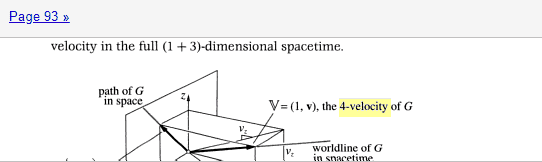

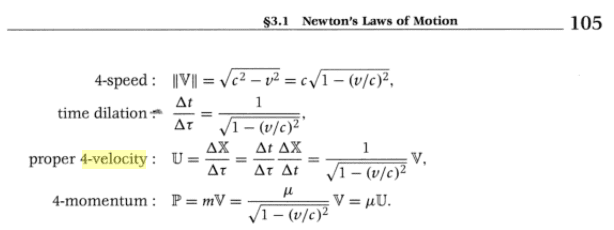

Slightly off-topic:
Let me point out that there is, unfortunately, a textbook that uses this
https://books.google.com/books?id=UMDurS6HSl4C&q=4-velocity#v=snippet&q=4-velocity&f=false
The Geometry of Spacetime: An Introduction to Special and General Relativity
By James J. Callahan
Later, he introduces a "proper 4-velocity" (which may be related to the use
of https://en.wikipedia.org/wiki/Proper_velocity (celerity) as the space-component of
this [Callahan-proper] 4-velocity . Note the use of relativistic-mass below.

Hm. So instead of using the standard meaning for "4-velocity" that every other source uses, he invents his own and then calls the standard 4-velocity "proper 4-velocity".
I would expect people who try to learn SR from this textbook to become very confused when they encounter the rest of the literature. Not to mention when they try to learn GR.
It's especially disappointing that this book claims to be about "the geometry of spacetime" but then focuses on things that aren't geometric invariants. It would be like trying to teach vector analysis in ordinary Euclidean 3-space by inventing a "vector length" that changed when you rotated your coordinates.
