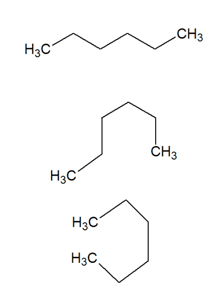

Bond rotation means that it typically doesn't matter how the molecule is drawn, all the molecules below are just hexane.

Thank you so much for your detailed response. It has clarified a lot for me.
I think my course expects me to name them the way I did; I was not aware it was an outdated method... this is for chem 12 in Ontario, Canada.
As for bond multiplicity your English is perfect. I have been seeing this term around but it was not explained in my course and when I tried to research it on the internet I did not really find any good clarification. I think I understand it now.
Alright so ethane and methane can't have methyl groups? I don't remember my course mentioning this but I will take your word for it.
The drawings as well were very helpful.
