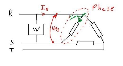

for example:
An AC motor is connected to a 3-phase R-S-T system with 400 volts.
The motor is in Delta configuration and every load is Z=1+2.5j .
A wattmeter is connected between the RS lines.
W=|VRS|*|IR|*cos(∠IR-∠VRS)=?
I tried solving using differenet methods we were taught, but every way i try i get a different result.

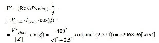

For example: 1) I thought that the wattmeter will measure the Real Power of a single load, which should be a third of the total Real Power of the motor. so:
on the other hand:
I'm starting to feel lost in this, so any help would be appreciated.
P.S. Maybe I should have done a Y-DELTA transformation? Although I'm not sure what good would that do...

A wattmeter connected as described will sense the voltage of each phase of the motor, but it will sense more than the current of a single phase of the motor, it will sense the phase current x √3.
With this correction, does that confirm your analysis?

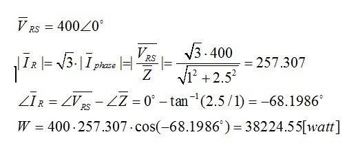

when I chekced the reading of the wattmeter (the second solution) I did multply the phase current by sqrt(3).
Or am I not getting your point?
What you calculated in the first step is the power in one phase of the motor. You will want to multiply this by √3 to compare it with your second calculation.
Where you write VRS / Z I think there is a missing √3.

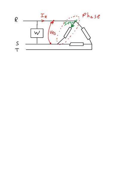

This is my understaing of the setup:
To my understanding, in a delta configuration (such as shown),
VLINE=VPHASE , so wouldn't that mean that IPHASE=\frac{V}{Z}? where does the √3 come from (if I want to use the power formula I mentioned in the first solution)?

A wattmeter has 2 pairs of sensing coils, one for voltage and another for current. I think it is unreasonable to believe you can routinely break open a delta motor and connect something in series with one of its phases to sense phase current!
You performed 2 calculations. Basically, the first is for 1/3 of the motor's power. The second is for 1/3 of (√3 of the motor's power).
My contention is that the best you can do is to have the wattmeter measuring the latter (whether you like it or not), sensing VRS and IR. You can't sense the motor's phase current, even if you wish you could. Well, that's my thinking.
Is that the wording of the original question? It sounds a sloppy way of expressing the arrangement.
It seems motor phase power is 22kW and total power is 66kW. So they must want the answer of 22kW.

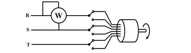

The switches are for a different, unrelated, part of the question- the setup is changed to Wye.
So it looks like the construction brings out the ends of each motor phase so that you can connect a meter in series with a single phase of the motor to meter the phase current! (Or at least it is intended to represent that.)
