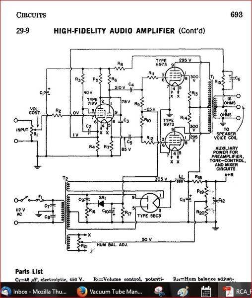

Can anyone help please, I have been searching for vintage valve amplifier circuit diagrams and components.
I need help in finding valves, transformers, and diagrams.
I intend to build amplifiers for a rock band so i would like to build one with a 3KW output if that is feasible.
Thanks for any help no matter how little.
My honest advice is
1. Search on terms guitar amp tube circuits, it'll return scores of sites with varying degrees of credibility
2. buy a copy of RCA Receiving Tube Manual (they're all over Ebay) from mid 1960's and build the fifteen watt hi-fi amplifier in their "Projects" section in back of the book. It has great tube sound(i built it one 1963) and will make a great guitar amp. It uses the 7199 low noise preamp which will "WOW" audiophiles.
Real reason to build it is to get your feet wet. Reading the tube manual will educate you in how tube amps work so you will be able to tell the internet wheat from chaff.
Get one 1960 or newer, you'll be better able to find those not so ancient tubes.old jim
I'm away from home right now so without my books. But last year i downloaded a copy of the RCA tube manual , from an archive site. RC30 is the version i have, about 35 megabytes.
Here's that amplifier schematic
very simple, good starter project.
https://archive.org/details/RCA_RC-30_1975
its rich sound will astonish you.
Be aware though you can buy a good transistor amp with better specs for less than the cost of a 7199...
old jim
unless you are an extremely experienced tech, forget building anything over ~ 100W

Jack Darr's "Electric Guitar Amplifier Handbook" (1971) is chock full of schematics, and still in print (4th edition).
Does that hifi amp have riaa EQ on the input?...assuming it's a phono input.
For a guitar amp, best not to start with a "HIFI amp" since many brochures of old HIFI amps had lines like "can pass square waves without ringing"...meaning...very little coloration of the sound.
Try www.triodeelectronics.com and check out the amp section...plenty of pictures and the site has tons of parts.
If you're looking for something that will take you through all the electronics required for guitar players (power supplies, pickups, amps, effects) I can't recommend "Electronics for Guitarists" enough but Denton Dailey enough. It strikes that balance where it is accurate and useful, but doesn't read like an engineering text (and you don't need a degree in Electrical Engineering to understand it). It starts from the beginning and goes from there.
You can get the second edition from Amazon for about $50: https://www.amazon.com/dp/1461440866/?tag=pfamazon01-20

@wolram - if you really think what you need are schematics of vintage tube guitar amps, there are loads of web sites that host all the schemos you could want; just start Googling; or else buy a copy of The Tube Amp Book by Aspen Pittman; it includes a CD with a massive amount of vintage schemos: https://www.amazon.com/dp/0879307676/?tag=pfamazon01-20
However from searching your profile page and your previous posts to find out how much electronics work you do, I found this recent post which suggests you are pretty much a beginner on soldering; this suggests you are also a beginner in electronics work in general: https://www.physicsforums.com/threads/lead-free-solder.901042/
If so I don't advise trying to work just from a schemo. Especially with high voltage tube amps, the circuits tend to be very noisy unless the lead dressing is very very good; and very dangerous to the end user unless constructed up to a given country's safety standards, e.g. proper strain relief for the power cord, proper means of fastening the Earth wire from the power cord to the chassis, an understanding of earthing principles, etc. etc. etc. Even experienced tube amp builders often have to troubleshoot their builds to fix problems with noise or with cold solder joints or other build problems. And working from a schemo, you'd have to design your own layout - a huge task for a beginner and one you'd probably get wrong unless you are an autodidact on the scale of Leonardo da Vinci.
Instead, from a beginner's building standpoint, I would suggest you look for and build a kit amp - a low-power kit amp to begin with. Kit makers assemble all the parts you will need & the favored designs tend to be vintage or close to vintage, e.g. a change to the schematic to ensure proper earthing. Kit makers include mainstream vendors such as Weber and Mojotone, as well as slightly smaller "boutique" vendors such as Allen Amps or Boot Hill. Note that Weber and Mojotone also sell components, along with many other vendors. Hammond (already mentioned) sells only transformers, and are very reputable; another excellent transformer source is ClassicTone. However most non-tube parts (passive, solid state, etc. ) are more cheaply obtained, and often of better quality, from industrial suppliers. In the U.S. this is chiefly http://www.mouser.com/ and DigiKey; there are surely equivalents in the U.K.

Wow, I thought this thread was done, Thanks for all the great advice, as for my ability, I started life as an electrician and I have worked with electronics before, mainly transistor circuits. And I did get my radio armature licence, but that was yeas ago.
That would certainly make a difference. A key thing with high-voltage DC circuits crammed into tight space = lotsa noise potential! So layout is a "craft" issue as much as it is understanding how noise propagates, e.g. capacitive conductance, radiation, etc.
But if you know transistors, valve theory is "same only simpler", basically - biasing etc. One nice thing is that graphical analysis of load lines, which apparently is not useful for most semiconductor circuits, is quite useful for valves; I have done a lot of that with help from Merlin Blencowe's books & articles (see my next paragraph) and some additional tips from a couple of EEs on The Gear Page forum.
