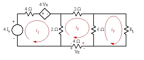

Check your equation for mesh 1; in particular the coefficient for the i1 term. In the second equation there should be a term for [/SUB]I3. The third mesh equation looks fine.
Now you want to solve for an expression for i3. Hint: if you set up the equations in matrix form and use Cramer's Rule, you can solve for i3 without having to deal with the other two...

What happened to the 4Ω resistor in loop 1? Here's the circuit we're dealing with:
my mistake i did forget the I3.
No worries, these things happen.
Ah you're right! I forgot about that as well.
so for mesh 1 i have
-4Io + 6I1 - 18I2 = 0
