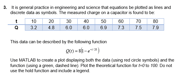

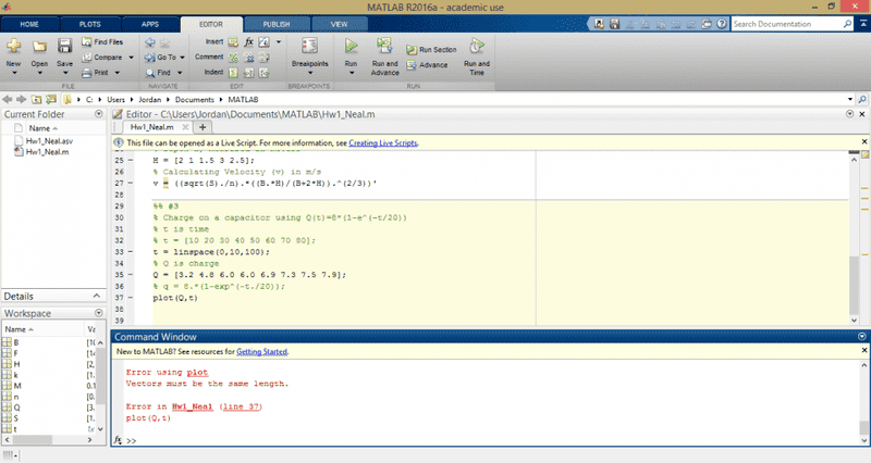

I'm a little lost on how to plot this data and function. I included the homework question and my attempt at plotting in the attached picture. I'm pretty sure what I have is completely wrong and I honestly don't have much of an understanding of matlab, so the more you dumb it down the better. Any help is greatly appreciated! :)

Your t array has more elements than your Q array and so MATLAB can't pair them together for an (x,y) point to plot.
As an example:
Matlab:
x=[0:1:10]
y=x.*x
plot(x,y)
produces two vectors ##x## and ##y## where ##y=x^2## and so the plot(x,y) draws a simple parabola.
In your case, MATLAB can't match up each value in t with one in Q and hence issues the error message you got.
Ask yourself why does t have a different length from Q? Isn't Q dependent on t somehow?
Here's the definition of linspace which may be the source of your problem:
http://www.mathworks.com/help/matlab/ref/linspace.html?s_tid=gn_loc_drop
Notice you used a 3 argument version where you want to create a vector t from 0 to 10 and you want 100 points and that's what you got but the Q is only eight points.
So one solution is to modify the linspace arguments.

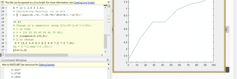

Ok, I tried changing a few things and managed to get a plot to come up, but I'm not super confident that its right. I was thinking that I was supposed to use linspace somehow to plug t values into my q function and then plot the actual Q and t vectors as data points on the same graph.. I hope that makes sense.
Or could I just say something like plot q and then somehow add the Q and T vectors onto the same plot as data points?
Also, did I type the q function correctly? Matlab keeps giving me errors when I try to run it.

A few things...
1. that plot looks correct.
2. you can use the following commands to make your plot look better
xlabel('string');
ylabel('string');
title('string')
legend('plot1','plot2',...)
3. exp is a function, get rid of the ^
exp(stuff) will execute the math function e^stuff
4. just do this
plot( t , vector1 , t , vector2 );
