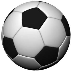

I don't think your idea about an all-hexagon mesh is possible. You can tessellate a plane into regular hexagons, because the angles work out nicely: 3 x 120 = 360. That has to be true "on average", even if the individual hexagons are irregular. And to make the mesh cover a convex surface, the angles meeting at a point must be less than 360.
Look at this, from http://en.wikipedia.org/wiki/Geodesic_dome - there are a few pentagons among the hexagons.
The same is true of a soccer ball:

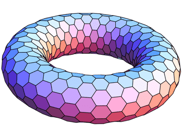

Yes that's what I thought but then I came along things like this...
and
They are from a post on Create a hexagonal mesh on a torus
I don't have access to Mathematica so unfortunately this isn't a solution. I would ideally like to be able to generate my own meshes on my own surfaces.
Your original post said "convex hull". That excludes a torus.
In principle, to make a hex mesh on a torus, you can make a hex mesh on a flat rectangle, join one pair of edges to make a cylinder, then bend it round and join the other edges to make the torus.
Not all surfaces can be covered using only hexagons. For example, you can't cover a sphere in only hexagons: you also need twelve pentagons. You can cover a torus in hexagons. Whether or not you can cover a surface in only hexagons is determined by its Euler characteristic.
My apologies, I appear to have used that term incorrectly.
Could you expand on this please?
In particular which Euler characteristics would allow for hexagonal meshing & why?
The basic idea of a convex hull is that if you take any two points on the surface, the straight line joining them is entirely "inside" the surface. That doesn't apply to a torus, because the line might go across the hole through it.
The basic ideas of Euler characteristics are on the page in The_Duck's link, http://en.wikipedia.org/wiki/Euler_characteristic
In the "soccer" ball section it calculates E for a mesh of hexagons and pentagons. If there are no pentagons the Euler characteristic would be 0. So you can cover a torus, a Mobius strip, or a Klein bottle.
If you use a few elements with more than 6 sides, you can get negative Euler characteristics so you could cover a double or triple torus. But you are on your own to work out the details :smile:
So if I have a surface that is morphologically the same as a torus I should be able to mesh its surface with hexagons?
Yes. (As in the old joke that a topologist is somebody who can't tell the difference between a teacup and a doughnut).
