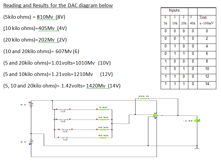

That doesn't look right to me. You also can't get 10V out if the power supplies are +/-9V.
Are you trying to make an R2R ladder DAC?
Hi, thanks for the reply, the diagraim was presented that way for me to do the calculations, i have also seen related diagraim online for DAC!
Yeah it,s ladder

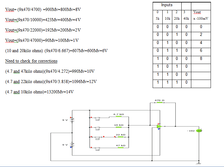

Well, can you explain this first line from your diagram? It doesn't make sense past the 900mV number...
Vout = (9V x 470/4700) = 900mV = 800mV = 8V
And why are the resistor values in your table different from the schematic?
Hi thanks for the reply. my target is to fill that table, those value of resistor in that ladder circuit we don't have most of the values practically, that's why i had to reduce the 9 to 8.
please take a look at this diagram and cross check.
That looks very close. The only problem I see is maybe the units definition for Vout in the last column heading of the table. It is hard to read the image, it shows 'x (something) 100mV'. What does it actually say?

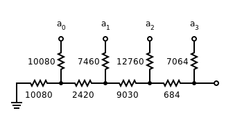

What you have shown is a Binary Weighted network.
A Ladder network is shown below. (From: https://en.wikipedia.org/wiki/Resistor_ladder)
To learn more, try a Google search for both terms.
Cheers,
Tom
