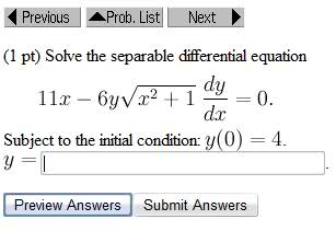

1) Find the particular solution of the differential equation for:
11x-6y\sqrt{x^2+1}\frac{dy}{dx}=0

Ah, right, forgot about the C. But I don't think that's what the question is asking for. Here's the question (My homework is posted on the web, :))
EDIT: Woops, just saw the last line of your last post just now. Let me do that and I'll get back to you.
Okay, so I got the C which is 2.085145784. So what I get now is y=\sqrt{\frac{-11(x^2+1)^\frac{1}{2}}{-3}}+2.085145784 yet when I submit it online, the webworks says I am wrong. I really don't get what I'm doing wrong.
