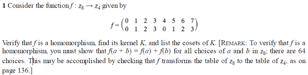

I did the first step, that is, show that f is a homomorphism. Now i need to find the kernel K of f. But i am a little confused how to find it. Seeing the image, can we say the kernel is {0,4}?

Yes, you are correct. The kernel are all elements that are mapped to the identity of the group (0 here), and these elements are exactly 0 and 4.
It might be easier than checking ##64## possibilities to show that the modulo function, which assigns the remainder ##r## in a division by ##n## to ##n##, and multiplication by ##m## are (additive) homomorphisms
g\, : \,\mathbb{Z} \longrightarrow m\cdot \mathbb{Z}\; , \;z\longrightarrow m\cdot z
f\, : \,\mathbb{Z}\longrightarrow \mathbb{Z}_n\; , \; z\longmapsto r \text{ where } z=q\cdot n + r\, , \,0\leq r<n
