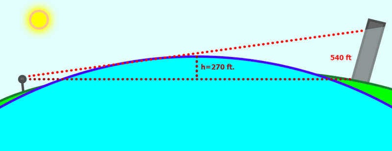

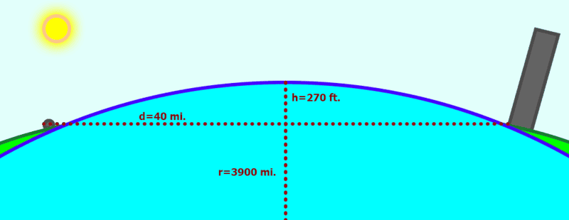

Thinking last night about what I should expect see of the Toronto skyline, which is 40 miles across the lake from me.
Starting with an ideal scenario (nape-of-shore to nape-of-shore), a chord calculator tells me that for r=3900 mi. d=40 mi. the chord height will be 270 ft.
Diagram of a curved Earth with radius r=3900 mi, showing a chord of length d=40 mi between two shore points and a midpoint bulge height h=270 ft, with a sun in the sky and a building on the right.
I was surprised at that height, and doubted my calculations. A 270 foot mountain in the middle of the lake is a lot! But I soon realized that it's not really a lot over 40 miles. It's rise-over-run of only 1:780.
At first I assumed everything below that 270 foot mountain would be obscured, so I would only be able to see buildings from the 28th floor and up (assuming they are at the waterline). But upon reflection, I think I won't be able to see anything below double that, or 540 feet.

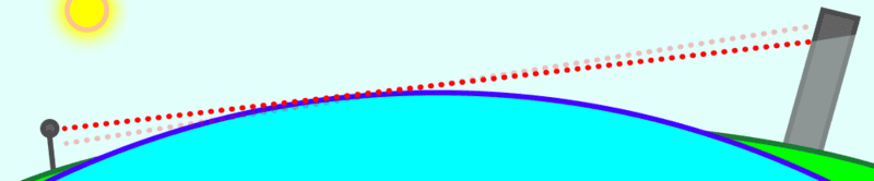

Diagram of Earth's curvature over a lake: a sightline from an observer on the left grazes the blue curve and rises to a tall building on the right, with a dotted horizontal line marking h=270 ft. at the midpoint and 540 ft. labelled at the building.
Confounding Factors:
  • I don't think my height above the water will make a difference if it's small enough. I mean, if my sightline is 10 feet above the waterline, that'll mean I can see down to 530 feet instead of 540 feet, right?
    Diagram of Earth's curved surface with two dotted sight lines, a red and a pale pink one, running from a figure on the left shore to a tall grey tower on the right, passing over the curve.
  • I also have to remember that the visible buildings are many metres above the waterline, so I can't just count building stories to estimate altitude.

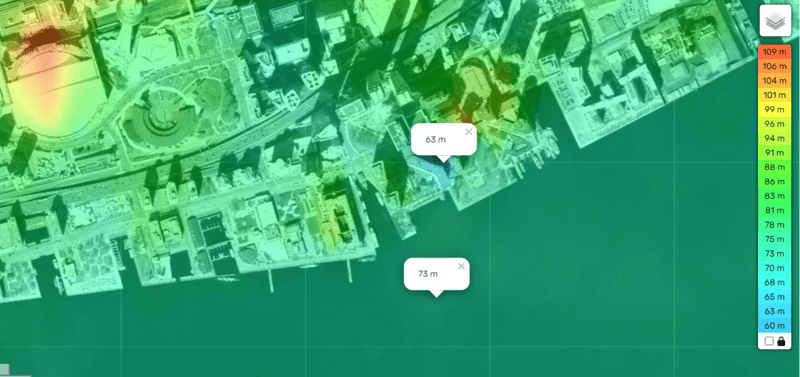

Researching how far above lake level the Toronto skyline is. Found this anomaly:
Aerial heat map of Toronto's waterfront with a colour scale from 60 m (blue) to 109 m (red); two callouts read 63 m near the harbourfront buildings and 73 m on the open lake.
West L. Ontario is pretty consistently about 73m above sea level (turquoise) so that's good.

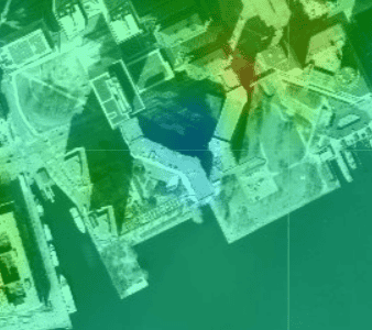

But this little blue-shaded area around the Harbourfront Towers reports as being 10m below lake level!
False-colour elevation map of a waterfront district with a dark blue patch in the middle, surrounded by green and yellow tones of surrounding land and buildings.
A rule of thumb (without refraction correction) is 8 inches per mile squared.
10 feet is 120 inches. Divide by 8 and get 15. Take the square root and your line of sight brushes the water surface right about 4 miles out.
That leaves 36 miles to go. Square that and we get 1296. Times 8 inches is 864 feet.
I think this calculation would be correct if you were on a Euclidean plane with a 270 foot wall 20 miles away. But you are on a sphere and, as the second and third diagrams in your OP show, your sightline touches the Earth considerably closer to you than half way.
Draw the Earth as a circle of radius ##R## on a piece of paper and you have $$\begin{eqnarray*}
y&=&\sqrt{R^2-x^2}\\
&=&R\sqrt{1-\frac{x^2}{R^2}}\\
&\approx&R-\frac{x^2}{2R}
\end{eqnarray*}$$where the last line is a first order Taylor expansion (the next term looks like ##x^4/R^3##, and for a 40 mile distance this is ##(40/4000)^2## smaller than the first and can be neglected). So the surface is ##x^2/2R## below where it is at ##x=0##. Plugging in the numbers, ##1/2R## works out to the ##8\mathrm{\ inch/mile^2}## rule cited by @jbriggs444.
Draw a horizontal line grazing the surface of the Earth at ##x=0##. It is 10 feet above the parabolic approximation at ##x=\pm\sqrt{10\mathrm{\ feet}\times2R}## which works out to a shade under four miles. The buildings are therefore at ##x=\mp 36\mathrm{\ miles}##, which makes their base about 850 feet below your sightline, in agreement with jbriggs444.

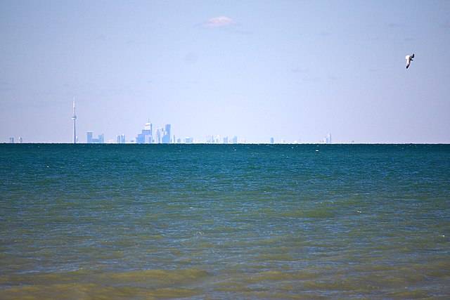

Anyways, there are plenty of images of Toronto from across the lake:
https://www.google.com/search?sca_e...&biw=2560&bih=1283&dpr=1#imgrc=Kg8POzr5HdgDFM
From Niagara (seems to be from the beach):
Photo across a choppy blue-green lake toward a hazy city skyline on the horizon, with a tall tower on the left and a seagull flying at upper right.
