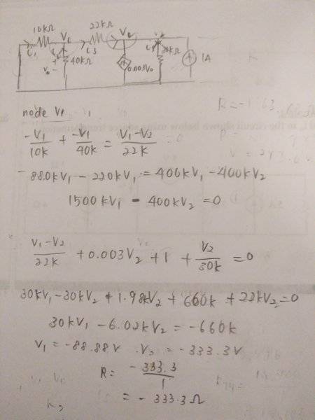

This is the question
First,I use thevenin theorem,when I close the voltage source, i apply nodal analysis to find rth,is my answer correct?

Dependent source 0.003vo should, with your nomenclature, be written 0.003V1

Halfway down the page of your calculations you have:
(V1-V2)/22k + 0.003 V2 +1 + V2/30k = 0
This should be:
(V1-V2)/22k + 0.003 V1 +1 - V2/30k = 0
Which should then become:
30 V1 - 30 V2 + 1980 V1 + 660000 - 22 V2 = 0
Which becomes:
2010 V1 - 52 V2 = -660000
Thank you for you helping,now i know my mistake
This should be:
Which becomes:
Thank you for your help.
I don't understand why - V2/30k ?

Because you have chosen to define currents into a node as positive. The other choice people make is to define current out of a node as positive. But whichever you choose, you must be consistent.
The expression V2/30k gives the current out of the node, so its sign must be negative.

ok, thank you for your help. In this circuit, I find the rth = -1363ohm. Is possible rth is negative? why?

The dependent source in this circuit is a transconductance source. The value 0.003 is the transconductance. Substitute a variable x for the value 0.003 and solve the circuit for Rth. You will get this expression: Rth = 3.75/(.00025-x). You can see that if x is greater than .00025, Rth will be negative; since .003 is greater than .00025, we get a negative value for Rth.
The circuit of this thread is an example of a circuit with an active element connected in such a way as to generate a negative resistance. There are other well known circuits that can do this, for example: https://en.wikipedia.org/wiki/Negative_impedance_converter
