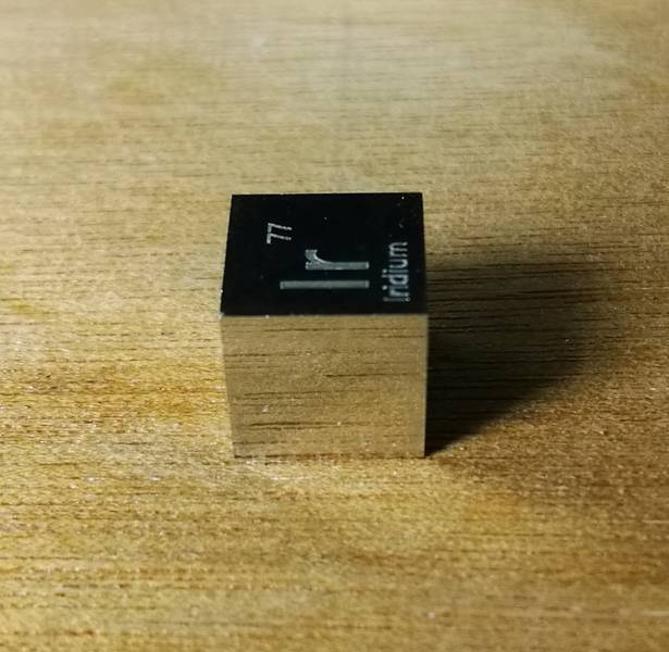

I thought I'd share a photo of pure iridium polished to a mirror finish. I don't know the process but clearly it's possible. If I had to guess, it was done with the aid of a flat lapping machine.
