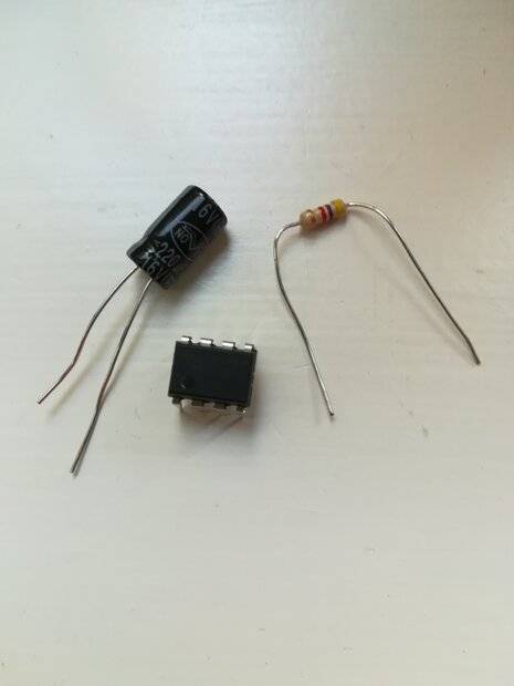

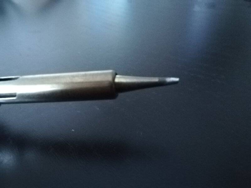

Some pictures of my soldering iron tip and some components that I use:

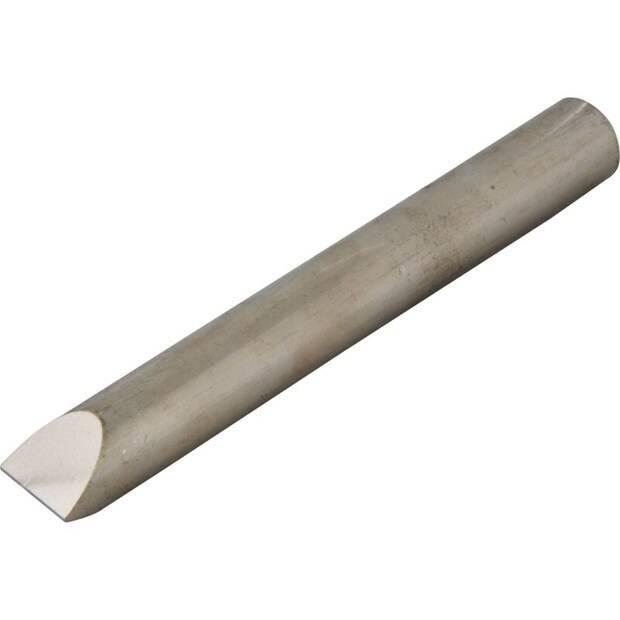

@StellarisVoid I'm pretty sure there are no regulations for what type of solder you can use at your own home as long as you can get it either from a store or from second hand sellers like ones on ebay.
Leaded solder is not exactly leaded gasoline which is burnt and then the lead exhausted as miniature particles and aerosols all around which you breathe in easily.
That being said you might want to consider soldering either in a well ventilated area or getting yourself a small fan and ventilation tube that exits the room which sits directly above your workbench and sucks the fumes in that rise up from the iron and board.
Unless of course you do this once a year then you can avoid it.
As for your soldering iron , I have to say I myself don't like these rounded cone shaped tips of the cheap store irons these days, they don't hold solder on them even when their fresh and clean.
I myself like the simple copper tips which are round but one side is cut at a 45 degree angle to axis and is flat.
That increases the surface area and the solder sticks better to it.
See these pictures for reference. Also check your iron, most modern irons , even the cheap ones have changeable tips , simply unscrew the end fastener nut and swap out the tip for a one with a different shape. Although looking at your iron I don't see such a nut so maybe yours can't be swapped.
But basically as others have said, good flux, clean tip, and ideally good flowing solder which is usually the older type with more lead to it.
The newer type solders are harder to use , you have to have more skill otherwise they end up like cold joints and lose contact quickly.PS. If you plan to solder IC's etc in the future be sure to ground your iron well, because the irons that work off mains voltage , especially the cheap ones, often develop some leakage voltage on their chassis which sometimes can even be felt by touching them.
This can be avoided either by using good grounding on the chassis or by using a different iron altogether. I for example took some mains irons and rewound them for lower voltage (42v AC) and run them on a mains isolation and step down transformer, with such configuration both I am safe as well as my small semiconductors because if you develop a voltage on your iron chassis you can easily damage semiconductors as you solder them.
Was the tip changed recently?
When soldering goes wrong (with changeable tips) the cause is often the loose mechanical contact between the heating element and the tip or some oxide particles between them. Or, occasionally, a mismatched tip...
I have never changed the tip of the soldering iron.
