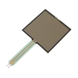

I have no idea of the forces present, but I envisioned something like this, simply fixed to the drum where the striker hits:
http://www.trossenrobotics.com/store/p/6496-1-5-Inch-Force-Sensing-Resistor-FSR.aspx
It's pressure range is 1.5 to 150 PSI, and my gut tells me that the hardest striker hits are going to be bigger than that, quieter hits may be somewhere in the range. Another consideration is whether it will interfere with the sound quality.

You will need to determine which transducer (pressure range) to use. Then the fun begins; interfacing it to your micro-controller and scaling it's output (maybe with an op-amp).
Good call. That would remove any detectable interference with sound quality that might have come from a pressure patch.
