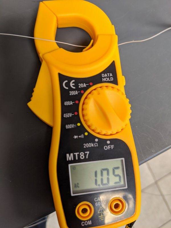

It seems I don't understand how magnetic shielding supposed to work. I tried shielding a wire, using some ferrites, but it doesn't work.
It seems I don't understand how magnetic shielding supposed to work. I tried shielding a wire, using some ferrites, but it doesn't work. I assumed the magnetic field will concentrate in the magnetic material, bypassing the meter magnetic loop, so less will be measured by the meter. I thought the ferrite is not proper for the 50Hz, so I tried a steel pipe I had laying around, but to no effect. What I'm doing wrong?
Ordinary steel, unless it is very thick, is rather ineffective shield against low frequency magnetic fields. Assuming you don't have superconductive materials or sheets of mu-metal, you should try wrapping around with several layers of mutually isolated permalloy strips. The shielded object should be completely situated in a space enclosed by the shield
Dusan Stan said:
Summary:: It seems I don't understand how magnetic shielding supposed to work. I tried shielding a wire, using some ferrites, but it doesn't work.
It seems I don't understand how magnetic shielding supposed to work. I tried shielding a wire, using some ferrites, but it doesn't work. I assumed the magnetic field will concentrate in the magnetic material, bypassing the meter magnetic loop, so less will be measured by the meter. I thought the ferrite is not proper for the 50Hz, so I tried a steel pipe I had laying around, but to no effect. What I'm doing wrong?View attachment 258632View attachment 258633
You cannot magnetically shield a wire this way. By Amperes law if you have a nonzero net current going through a loop then you will have a nonzero magnetic field along that loop. No shielding can prevent that.
If you want to limit the magnetic field of a wire then you need to make sure that there is no net current through any loop outside the wire. You can do this with coaxial cable or twisted pairs.
Coaxial cable will completely eliminate the external magnetic field. Twisted pair will not eliminate it entirely, but will reduce it a lot. Plus it is less expensive than coaxial cable.
If you use twisted pair and need further suppression then your ferrites may help. But the first and most essential thing to do is to get rid of the net current.

The wire can be shielded in this way (more or less successfully) but the effect of shielding can't be measured by a clamp meter like shown in the photos. As matter of fact the clamp meter can react to local AC field and show readings even in the case of zero current through the wire. That's the main reason clamp-meters are recommended only for strong current measurements.
Yes, many of these meters are unreliable. But the good ones actually work quite well. Fortunately it is really easy to do a cursory test to spot the bad ones. This isn't the best instrument to get as a cheap ebay brand. This is a case where you get what you pay for.
As you said, you can look for zero reading when there is no wire inside, hold the closed meter as close as possible to the measurement location and check for zero (or an error small enough to be ignored). You can also try reversing the polarity and look for the same answer. Many clamp-on meters say the wires should be near the center of the loop, but you can easily test yours to see if this matters. Whenever possible compare to other measurements, like a different brand meter or know currents. Overall, be skeptical and do a constancy check; the good meters don't change their answer when you move stuff around. The DC clamp-on meters are especially prone to errors, you should almost always check the reverse polarity on these.
Keep the contact surfaces between the core halves clean and make sure the clamp is 100% closed.

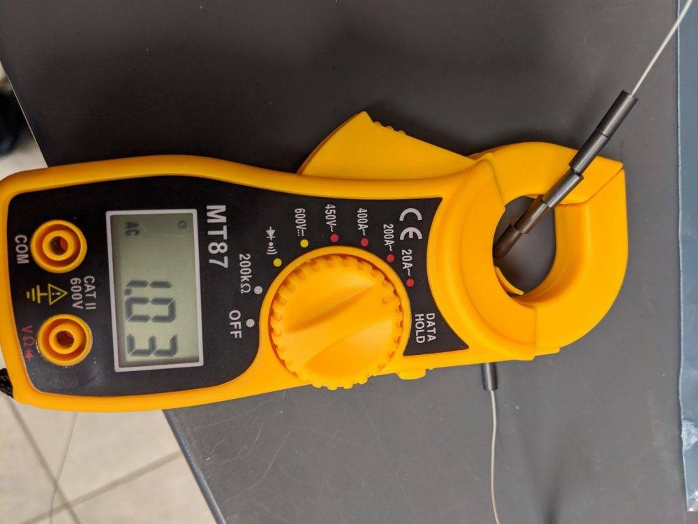

Quote from the link below "First, one important point must be clear: Magnetic shielding does not block a magnetic field. No material can stop the lines of flux from traveling from a magnet's north pole to it's south pole. The field can, however, be redirected"
https://www.kjmagnetics.com/blog.asp?p=shielding-materials
Because the magnetic field cannot be blocked by covering the current source with ferrite, you can try to completely shield the coil current sensor of the clamp meter with a high permeability material.
Since the magnetic field can be redirected (but not eliminated) by this measure, the magnetic field will no longer pass through the coil current sensor and no induced voltage will be generated.
Of course, this is just an interesting experiment and has no practical use , but anyway, I think it might work.
The clamp contains a magnetic core that is mechanically closed about the wire. The flux through that core is due to current in the wire, and is measured in the meter.
When you put a ferrite core about the wire you give the flux an alternative path that does not pass through the clamp meter circuit. That is why the reading falls slightly. The beads threaded on the wire are providing a magnetic short circuit for the flux, so it does not go through the sensor in the meter.

So, what is really going on in the OP's circuit ?
1. The clamp meter.
The meter shown in post #1 measures AC current only, so it is almost certainly a current transformer with a mechanically closed magnetic path and a low resistance burden on the multi-turn secondary. A clamp meter appears as the clamp inductance, inserted in series into the wire, but short circuited by the internal transformed secondary burden.
Doing the numbers; If the clamp had a 40 turn secondary, with 0.1 ohm burden, then for 400 amp in the primary it would have 10 amp in the secondary, dropping 10 A * 0R1 = 1 volt across the burden. That is what the instrument measures, scales, and displays as “400”A.
The 0.1 ohm load would be transformed to appear as a series drop of 1V / 40 turns = 25 mV in the single primary "turn".
The equivalent parallel resistance is 25 mV / 400 amp = 0.0000625 ohms.
Note how the square of the turns ratio transforms the secondary burden, to 0.1 ohm / 40² = 62μ5 ohm in the primary.
The meter appears as the clamp inductance in parallel with a 62μ5 ohm series resistor. The maximum voltage drop in the wire being “measured” is 25 mV. All without cutting the wire.
That 25 mV drop reduces the available load voltage and so reduces the current drawn in the circuit while the clamp is in place. For a 230 V circuit that will be a current reduction of about 25 mV / 230 V = 0.01%.
2. The ferrite beads.
Threading the wire through non-conductive ferrite beads increases the self inductance of the wire, and so reduces the AC current flowing in the circuit. But the inductance of the non-conductive bead is not short circuited by any burden as is the clamp meter inductance.
Each ferrite bead adds another series inductor (probably less than 1μH) to the circuit. The beads appear to be small and made from a ferrite designed for low loss at MHz frequencies. Since the bead reactance is XL = 2·π·f·L; those beads will not be significant at 50 Hz, but their inductance will oppose the flow of RF along that wire.
Doing the numbers, 10 beads at 0μ5 H each makes 5 μH.
At 50 Hz we have XL = 1.57 milliohm in series with the wire.
At 1 MHz we have XL = 31.4 ohm in series with the wire.
3. The steel pipe.
Threading a short steel pipe onto the wire will result in bad 50 Hz effects since it is a conductive solid steel core magnetised by the current in the single wire. The metal sleeve will get hot due to eddy currents flowing in the surface. That is why you must NEVER pass a single AC wire through a conductive aperture. You must pass all the return circuits through the same aperture to cancel the induced magnetic field, and so prevent inductive heating and energy loss. That is true for single and three phase AC circuits.

Lesson learned. After more experimenting: - different frequencies and measurement methods; - even filling most of the space of the clamp with leftover transformer I cores, the measured current stays the same.
The idea was to find a way to prevent generation of external magnetic field without cancelling the current, but apparently, this is not possible.
Thank you all for your input.

Shielding question can be separated to two cases: what is shielded from what?
First case: Can a wire be shielded from external AC magnetic field by placing it in appropriate enclosure?
Answer is yes, and for best result superconductive shield tubing should be used. Since I was initially unable to view your attached photos, and text alone appeared to ask about this case, my answer was given accordingly.
Ability to view the photos revealed the second case you were actually interested in: Can an external space be shielded from the magnetic field of current passed straight wire by placing it in appropriate tubing? Answer is no, regardless of what kind of tubing material you use.
