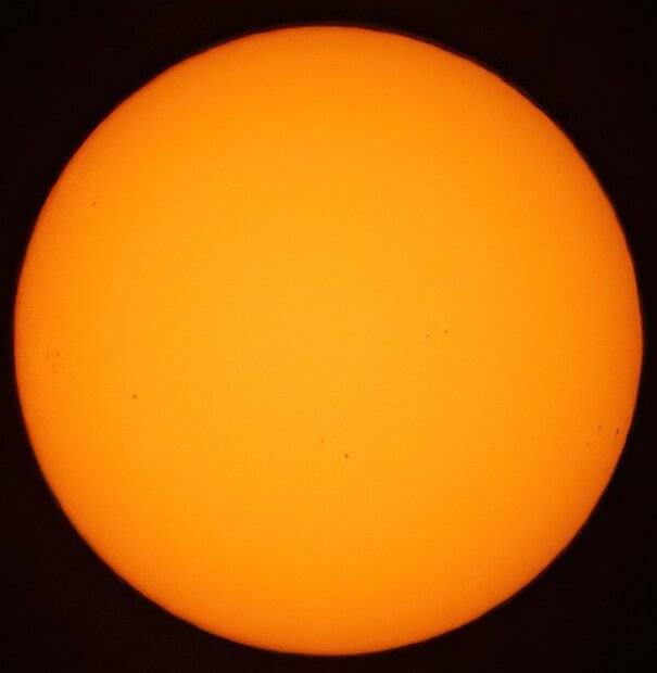

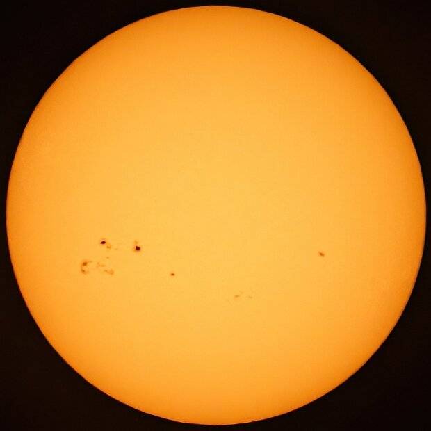

  • #183

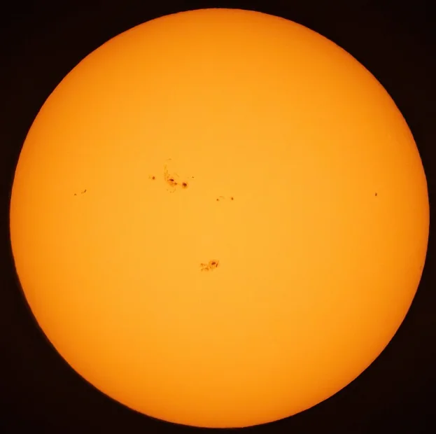

09 Sept. 2018
The Sun in Ha
Hi guys,
first solar observing for a month. Winter time isn't conducive for having the sun in the sky outside of work hours. Some nice prominences to be had this weekend
Lunt 60mm Ha solar scope, 12mm BF, Televue x2.5 Powermate, ASI1600mm Cam and Sharpcap
cheers
Dave

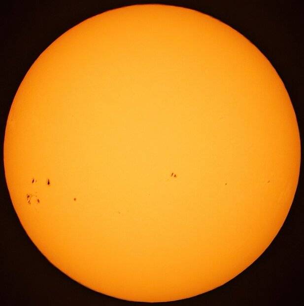

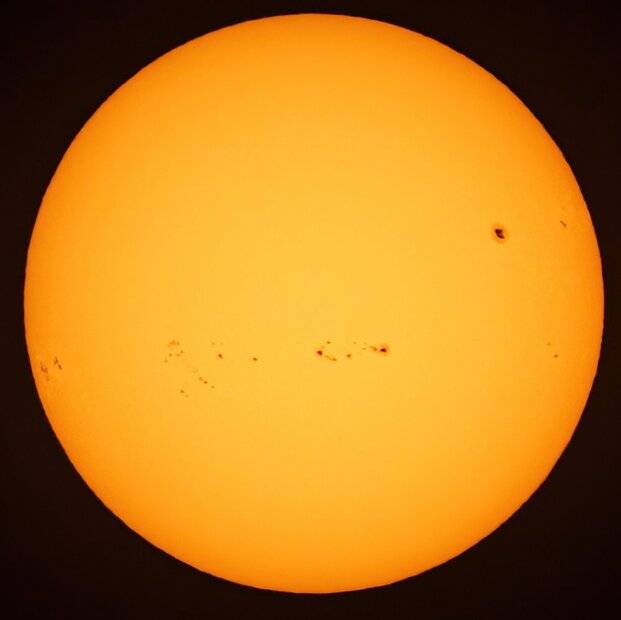

  • #184
The Sun in Ha 30/09/2018
Nice hedgerow prominence and a small spot group
Lunt LS60 THa and ASI 1600MM
The first 2 images just scope and camera last 2 images with Televue x2.5 Powermate
Dave

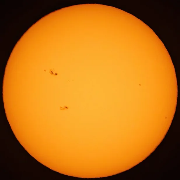

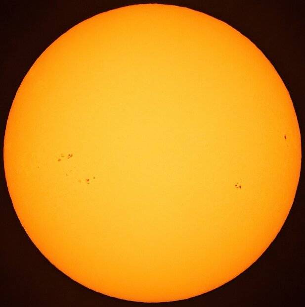

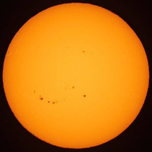

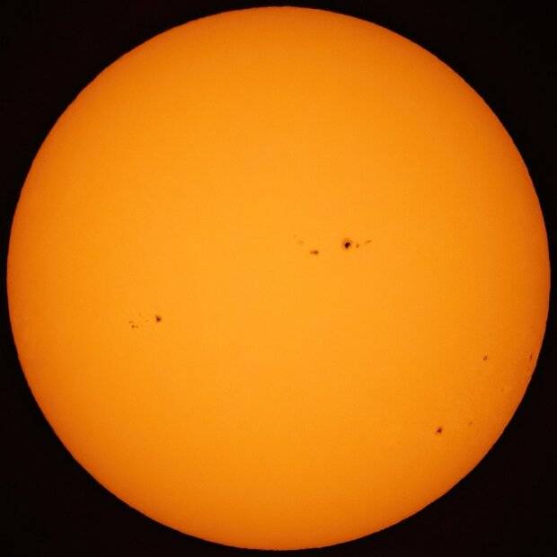

  • #185
After months of no solar images from me ( for various reasons) I finally managed to get some today (Sat 13th Apr)
These are just single shot images ( no stacking) with my Lunt LS60THa ... the close up image is with the Televue x2.5 Powermate inline. Camera is the ZWO ASI1600MM
  • Love
  • #186
Fab detail!
  • #187
sophiecentaur said:
Fab detail!
Thankyou :smile:

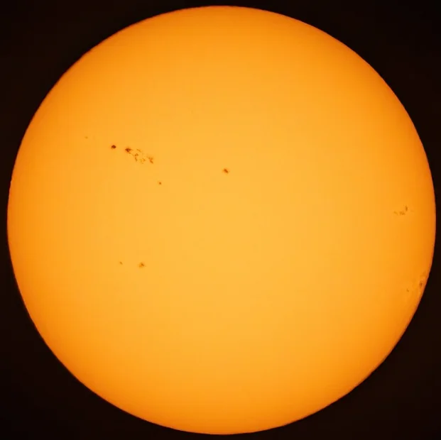

You may have noticed that curved banding in the closeup image ( also on an earlier post)
These are Newtons Rings caused by slight misalignment along the optical path somewhere
It isn't noticeable on the usual images, but as soon ad the 2.5 multiplier is in line, they become very obvious.
I have a tilt adaptor on order, hope to see it in a week or 2
https://www.bintel.com.au/product/zwo-t2-tilt-adjuster/?v=6cc98ba2045f
The above shows the tilt adjuster with the imaging camera mounted behind it
Interestingly, the NR's can be removed using FFT processing of the image. A fellow solar photographer took that image of mine and processed it in Photoshop with a FFT plug-in
Before...
After ...
DANG ... what a difference !
I have tried and tried to do this with the PS plugin that he uses, and I just cannot figure out how he does itDave

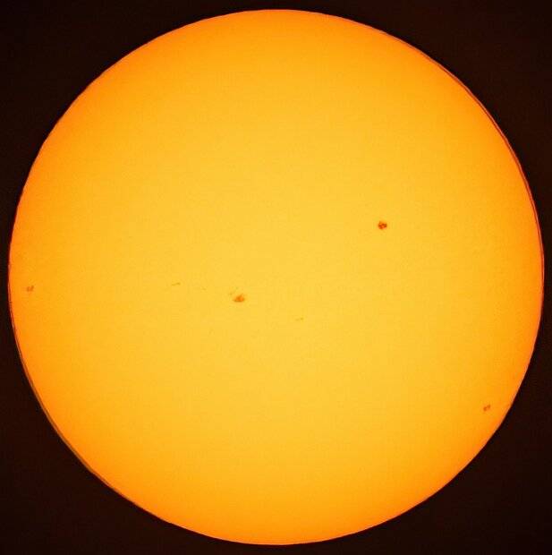

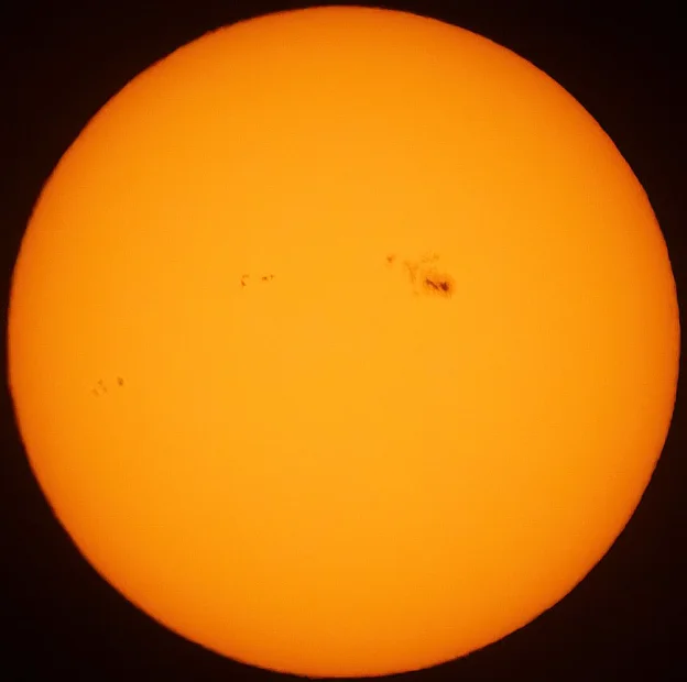

The Sun today - 07 May 2019 0130UT (1130 AEST) ( Australian Eastern Standard Time)
Lunt LS60THa single frame exposures with an ASI 1600MM Camera
AR2740 and with AR2741 just coming around the limb
(AR = Active Region)
Well the Tilt Adjuster works and got rid of the Newtons Rings in the higher magnification images:smile:
if you follow the link you can see that there are sets of screws that can be adjusted. The adjustment of these removes alignment errors between the optics and the imaging sensor that cause the Newtons Rings that can be seen in images I have previously posted.Dave
  • Wow

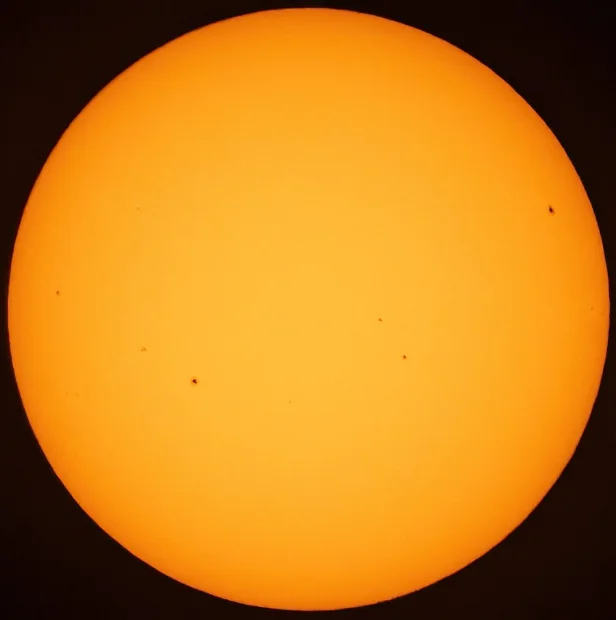

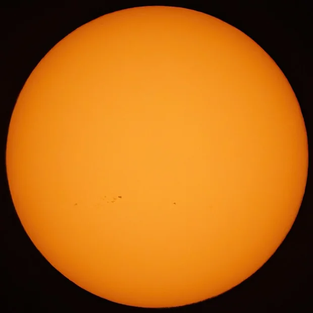

  • #190

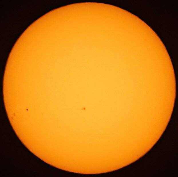

The Sun, 14 May 2019
One significant active region AR2741
One reasonable prominence on the limb
LUNT LS60THa Solar scope, ASI 1600MM and ZWO Tilt Adjuster
Dave
