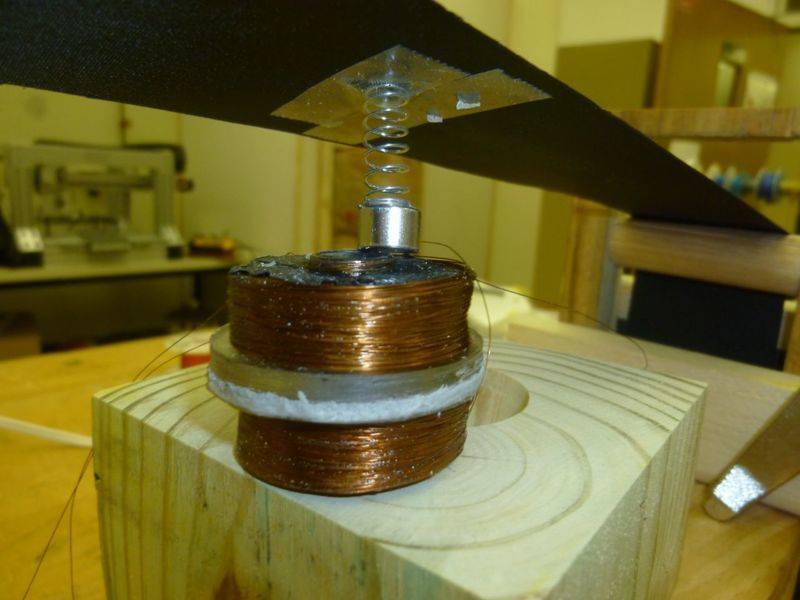

Having seen your picture, I think I can see that the reason for such a low output voltage is the physical arrangement of coil, core and magnets. You need to have a very low reluctance magnetic circuit, with tiny gaps and a good coil so that you get a good dϕ/dt and lots of turns going through the field.
With your arrangement I should imagine it would be very possible to monitor the movement by amplifying the signal but it is another ball park to get useful power out.

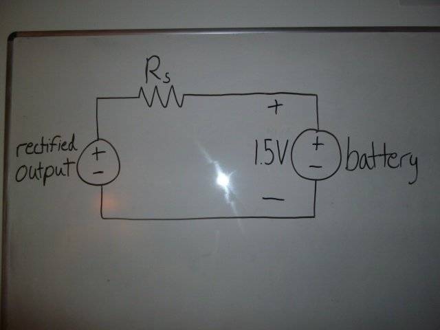

Just a question about our voltage and current measurements, though. When we are measuring the voltage and current of a single coil, we connect the multimeter to both of the open-circuited coil ends and measure both the AC voltage and AC current in that position. So it seems like we are measuring the open circuit voltage and the short circuit current produced by the coil. If we connect this coil to a 1.5V battery (after rectification), will our current going into the battery be much less than the short circuit current we measured with the multimeter?
Another question. Assume we take the AC output from the generator, rectify it, and then send it to the battery. Where does the linear wire resistance (ohms/meter) of the coil come into play during this process? Looking at my attached image of the simple circuit diagram, is R_s the resistance of the coil (all ~100ft of wire in the coil) or is it something else?

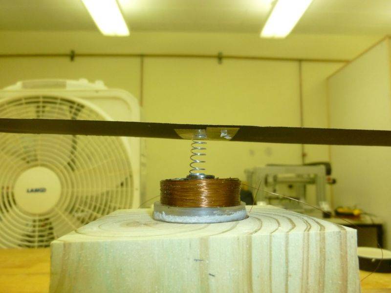

Regarding the design of the generator itself, I think there are some improvements we can make. We found out last week that our belt can withstand larger magnets so we will be testing those out later today to see how much our output improves.
Our magnetic circuit may be as good as we can make it right now. As you can see in the attached photos, we have tried to improve the magnetic circuit by attached a small spring to the underside of the belt along with a small magnet hanging from the spring. The magnet hangs into a cylindrical coil so it is always inside the coil with a very small air gap while it is moving. If we make the air gap any smaller, I am afraid that the magnet may start rubbing the inside of the tube while it is moving and impede its motion. Additionally, we have to wind the coil around something (a very thin plastic tube in our case) and finding something just barely smaller might be difficult. We thought about doing some sort of iron core but we realized that the main advantage of the windbelt is that it is dirt cheap. Adding iron to each coil would increase the cost and, unless the gains were quite significant, the power/$ ratio would probably decrease. We are still trying to optimize the generator by testing magnet placement and other variables. For the windbelt Shawn Frayne was using in his video, he was only able to generate 40mW with 10 MPH winds. We are using 8 MPH for our testing.

If you plan to add the contributions of several generators then the addition must be done after DC conversion of each output because the relative phases (and even frequencies) of all the AC contributions would be random and would not produce a useful waveform. There will be a lot of 'beating' between the outputs and frequent cancellations.
I can't see that the addition of an iron yoke would be a "significant" addition to the cost. Scrap transformers come free and many of them can be dismantled. "kit' transformers are not very pricey either. You should really try something, I think. But it all depends on how far you want to go with improvements.
You will definitely find the project an interesting one even though it is unlikely to produce seriously practical results without further work. You will get a feel for the subject - which is what it's all about.
Question about the coil:
As you can see in the first attached picture of my previous post, this coil is basically two smaller coils glued together with a plastic washer in between. During testing, all four leads (two per coil) are accessible. We have to connect a lead from each coil together such that the generated emf from each coil adds together. If we connect them together incorrectly, the emf's from each coil will subract and we will get a poor output. Correct?
This has been our thinking thus far. Well, today we made a coil about the same height as the one in the picture seen above, but it was made out of one continuous wire strand (basically one big coil). We did not get very good results with it. Here is my thinking:
Let's assume the magnet is in the middle of the coil and is moving upward. For the top half of the coil (where the magnet is moving towards it), the flux is increasing with time, and creating a positive voltage in the top half of the coil. At the same time, a similar thing is happening in the bottom half of the coil except, since the magnet is moving away, a negative voltage is created here. Since the top and bottom half of the coil have opposite voltages, the total emf(voltage) of the coil is very low.
Is this what is happening and does it make sense?
When the magnet is in the middle of the coil, the two poles of the magnet generate equal and opposite voltages in the coil (although in different parts of it) and these would tend to cancel out at the terminals of the coil.
