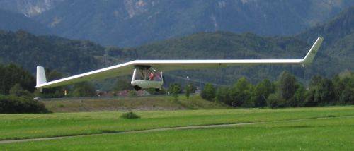

Since SWIFT gliders do not have tails, what stops them from going into forward/backward spin ?

I'd say it's referring to this:
https://en.wikipedia.org/wiki/Aériane_Swift
In which case the role of a vertical stabilizer at the tail is replaced by winglets on the main wing.

If you look at your standard aircraft there are a lot of redundancy points. Technically the spoilers, the flaps, and elevators, and the ailerons will all effect pitch. During normal operation the elevators act as your primary pitch control while your ailerons act as roll control. But there are many stories of multiple control surfaces being damaged or destroyed and pilots still flying home. WHY? because the control surfaces are redundant.
With the glider you posted, there is only 1 wing, with however many control surfaces on said wing (I'm not sure if they just have ailerons, or spoilers and ailerons. The ailerons on the swift glider can still control pitch if they move up and down at the same time, it is only when they counteract each other (one up, one down) that roll occurs. To control pitch on a swift glider, one just needs to move the ailerons up and down together.

There are two main ways of providing longitudinal stability on a tailless aircraft...
1) Straight winged aircraft use special wing sections that have a reflex camber (sweep up) at the trailing edge. This and a forward center of gravity provide the necessary longitudinal stability. Example wing section for tailless aircraft:
2) Swept wing aircraft typically use wings that are twisted so the wing root and tips are at different angles of attack. Usually the wing tips are at a more negative angle of attack than the wing root. The twist can either be an actual twist or an aerodynamic twist or a combination of both. (Note: This should not be confused with washout which is to aid lateral stability close to the stall).
There is a good explanation of the issue here by someone who has designed wing sections for tailless aircraft..
