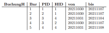

Hey! 😊
Consider the relations Personen, Hotel and BuchungH :
1. Create the three relations in the database.
2. Insert the tuples in all tables.
3. Create meaningful keystones for all tables.
4. Give an expression that deletes again the tables. Could you explain to me what we are supposed to do? Do we have to create the tables with SQL commands? :unsure:
If it is like that, then do we have the following at 1 ?
CREATE TABLE Personen (
PID int,
Name varchar(255),
CREATE TABLE Hotel (
HID int,
Name varchar(255),
Ort varchar(255),
CREATE TABLE BuchungH (
Bnr int,
PID int,
HID int,
von int,
bis int,
); Is everything correct and complete? The length of 255 is standard? Or does it depend each time on the specific table? :unsure: At 2 do we have the following ?
INSERT INTO Personen
VALUES ('1', 'Schmidt'),
('2', 'Meier'),
('3', 'Beier'),
('4', 'Bauer'),
('5', 'Wolf');
INSERT INTO Hotel
VALUES ('1', 'Beach Club', 'Mallorca'),
('2', 'Radisson', 'Mallorca'),
('3', Le Flaubert', 'Nizza'),
('4', 'Ibis', 'Nizza'),
('5', 'Ibis', 'Mailand');
INSERT INTO BuchungH
VALUES ('1', '1', '1', '20211030', '20211107'),
('2', '2', '1', '20211030', '20211107'),
('3', '3', '4', '20211031', '20211104'),
('4', '3', '2', '20211030', '20211107'),
('5', '4', '4', '20211031', '20211108');
Is everything correct and complete? :unsure: Could you explain to me questions 3 and 4 ? :unsure:

Hey mathmari!
I think "von" and "bis" should be DATE's instead of integers. 🤔
For now we can use a length of 255. If the database grows bigger, it might help to use a fixed length string to improve performance. That is not a consideration now though. 🤔

If the type of a field is integer, then we should provide a value without quotes. 🤔

So do we have the following ?
1 :
PID INTEGER,
Name CHAR(255),
HID INTEGER,
Name CHAR(255),
Ort CHAR(255),
Bnr INTEGER,
PID INTEGER,
HID INTEGER,
von DATE,
bis DATE,
2 :
VALUES (1, 'Schmidt'),
(2, 'Meier'),
(3, 'Beier'),
(4, 'Bauer'),
(5, 'Wolf');
INSERT INTO Hotel
VALUES (1, 'Beach Club', 'Mallorca'),
(2, 'Radisson', 'Mallorca'),
(3, 'Le Flaubert', 'Nizza'),
(4, 'Ibis', 'Nizza'),
(5, 'Ibis', 'Mailand');
VALUES (1, 1, 1, '20211030', '20211107'),
(2, 2, 1, '20211030', '20211107'),
(3, 3, 4, '20211031', '20211104'),
(4, 3, 2, '20211030', '20211107'),
(5, 4, 4, '20211031', '20211108');At the dates we need the quotes, don't we? :unsure:
Yes, we need the quotes. But I think it should be like '2021-10-30'. That is, it seems the DATE format is usually YYYY-MM-DD. 🤔
Ah although in the given table we have all number together wew can nwrite that in this way, right?
So do we have :
VALUES (1, 1, 1, '2021-10-30', '2021-11-07'),
(2, 2, 1, '2021-10-30', '2021-11-07'),
(3, 3, 4, '2021-10-31', '2021-11-04'),
(4, 3, 2, '2021-10-30', '2021-11-07'),
(5, 4, 4, '2021-10-31', '2021-11-08');:unsure:
