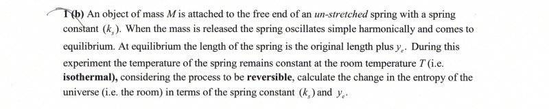

sfgoat
I have already submitted these questions and have gotten them wrong. I'm just wanting to see how to properly do it. Thanks.
I can't read your attempt. Can you type it here?
The spring itself keeps its temperature, it won't change its entropy in a notable way.
