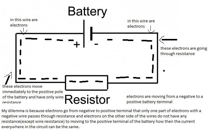

Current is like a bicycle chain --- all parts move at the same time. Actual electron movement is MUCH slower than you probably imagine. Google "drift current"tor2006 said:Greeting .
It is clear to me that the resistor represents a physical obstruction to the passing current I do not know how exactly it works and I will try to show what I was really interested in the diagram.
Frenemy90210
Resistance is a property of the material; e.g. Metals have a lot of free electrons, which means in general they have less resistance. Higher the resistance, lesser the number of free electrons in the material. These electrons are what carries the current. (at speed of light)

No, electricity in conductors does not travel at c but at a slightly lower speed.Frenemy90210 said:Resistance is a property of the material; e.g. Metals have a lot of free electrons, which means in general they have less resistance. Higher the resistance, lesser the number of free electrons in the material. These electrons are what carries the current. (at speed of light)

No, they travel even slower ... Drift velocity is mm to cm / sec depending on conductor and magnitude of the current
https://en.wikipedia.org/wiki/Drift_velocity
The only thing that travels at near the speed of light is the pulse of the EM wave along the outside of the conductor
In a DC circuit, it is a single initial pulse when the circuit is switched on. In an AC circuit, it is a cycling pulse at the rate of the AC signal frequencyDave

A longitudinal wave of compression and rarefaction must also travel through the outer electrons in the conductor. Or not?davenn said:The only thing that travels at near the speed of light is the pulse of the EM wave along the outside of the conductor

I specifically was not talking about electrons and drift velocity but electricity (that is, current)davenn said:No, they travel even slower ...
- 9,750
- 11,988
phinds said:I specifically was not talking about electrons and drift velocity but electricity (that is, current)
basically the same thing ... current is the flow/movement of charge (s), those charges are the electrons
As I said, Only the EM wave travels at near light speed
