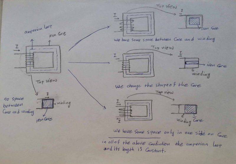

hello everybody!
I have a problem with ampere's low.assume that we have an iron core with a winding in on side of it as sketched in the below image.we want to find H(magnetic field strength) and B(magnetic flux density) in the core in different condition shown in the right of image .the cross-section area of the core is constant in every points and we don't want to ignore core reluctance.in all of the conditions,the ampere loop, winding turns and the current pass through the conductor is constant. according to ampere's low, H must be equal in all of these conditions.but,simulations have different result and H change in each of the conditions.intuitively,the H should be different because of changing in the distance of winding from core.so,why ampere's low can't show the difference in H?
Maybe I twill help if you write down Ampere's law. Then you can notice that it isn't just "H must be equal" but rather it is an equation. And the equation has various parts. And those parts relate to the things that are changing in the different cases.
the ampere's low says:integration of dot product of H in l(where l is the unit vector of ampere loop that is tangent to path)over a closed loop will be equal to N*I.here ,we can assume that the angle between l and H in all of the points of ampere loop(shown in the image) is zero, so dot product converted to numeric product and we can say:the integration of (H magnitude)*(l) is equal to N*I.we neglect flux leakage(and the area of cross-section doesn't change ),so the magnitude of B and H is equal in each point of the core.and eventually the magnitude of H depends on N,I and l.in the above conditions all of these variables is equal so according to ampere's low H must be equal in all cases.(but it doesn't in fact)

So you seem to have a contradiction. What did you forget?
Are B and H really "equal in each point of the core"? How are B and H related?

Pretty sure I did answer your question. I said: So you have a contradiction. What did you forget?
What changes between your cases? Does the thing that changes appear anywhere in Ampere's Law?
