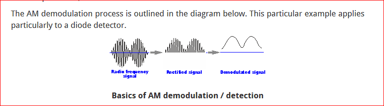

Sorry, here's the demo
"I converted into mp3 and then ran it through a software program that rectified it. Then I lowpassed it so frequencies above 500 hz were removed (the carrier frequency is 558)"
Ok so i'll do another low pass at 225 hz (or 200 to be safe)
there won't be much audio in that case but yeah.
Also your comment is really helpful, thanks!

That doesn't look rectified...
  • #33
Well I don't think it's rectified in the audio example

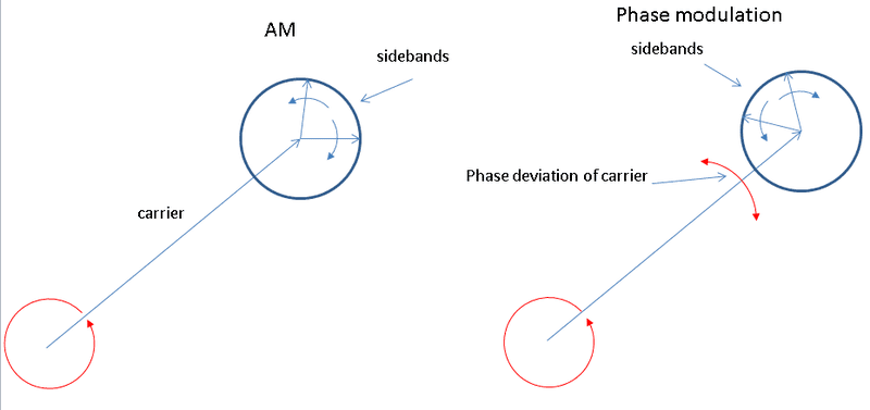

Tremolo is a fair way to describe FM as the carrier frequency is varied by the modulating signal. When the frequency deviation is high the carrier can actually be seen to sweep from side to side when you look with a spectrum analyser . That would be, for instance if you swept the carrier frequency from +10kHZ to -10kHz relative to the steady value (of 100kHz) at a rate of, say 50Hz. But sometimes the frequency deviation is low and the carrier deviation might only be +/-1kHz with a modulation frequency of 2kHz. Then the spectrum of the modulated signal really becomes unrecognisable to the eye. Nonetheless, the system works and a suitable FM demodulator can dig the modulating signal out of the received signal. The Maths of FM is a nightmare compared with AM.
On the whole, though, analogies are not very fruitful and you need to use Maths in order to get a good grip of signalling processes. It is a good thing that AM, at least, can be done in pictures!

What happens when we add two similar amplitude sinewaves that have very close frequencies? We hear a beat frequency between them that is actually an AM tone = tremolo. Is our ear unable to separate the two individual frequencies because they are too close?
It is easy to believe that the beat frequency we hear must be a non-linear product, but that is certainly not the case in a linear environment. We are actually hearing the variation in amplitude of the sum. The difference frequency or detected envelope would be too low in frequency to be heard by our ear. We could feel the difference frequency alone as a physical push–pull, but not hear it.
A human, tuning a piano, compares the frequencies of two notes by listening to the tremolo of their linear sum. When those combined notes have no audible tremolo, it suggests to me that the two strings, (or oscillators), have “coupled” and so are then harmonically phase locked and being pulled to the same harmonic frequency.

When the separation of the two signals is less than the bandwidth of the analyser, there can be no sidebands. Our ear is unable to differentiate the two frequencies because they both stimulate the same hair cells in our “spectrum analysing” cochlea. We then hear the constructive–destructive interference between the two as their phases pass slowly. That sounds to us like AM.
Where the frequencies are not audibly different, where they interfere, or where the oscillators actually lock, is a fascinating corner or audiology.
