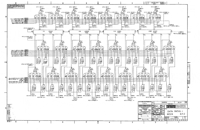

In my day minicomputers were built from them and a CPU occupied maybe three 15 inch square circuit boards, and other boards of same size would hold perhaps 8K each of magnetic core memory. A 16 bit computer with 32K of memory was be the size of a small refrigerator and weighed maybe ninety pounds. Of course now it's smaller than a postage stamp...
We troubleshot them gate by gate with a 'scope .

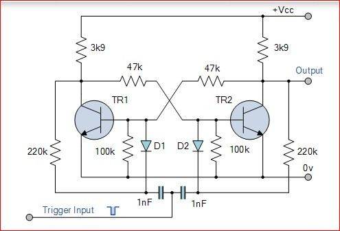

We boys each built a two transistor "T" flip-flop circuit like this one from http://www.electronics-tutorials.ws/waveforms/bistable.html
A negative pulse at Trigger makes it change state, so if you feed it a pulse train you get out a square wave with half that frequency.
If you connect a second one at output of first one it'll divide frequency by two again.
A once per second pulse at Trigger input of first one will cause it to produce a 1/2 hz square wave. Second one will produce a 1/4 hz square wave, and you can cascade as many as you want. We cascaded twelve of them and drove the first with 1 hz from a function generator.So that we could see something move, we connected a Simpson 260 analog voltmeter to each flip-flop's output. Each meter was placed adjacent its flip-flop.
set to 10 volt scale of course...We arranged them left to right on a long workbench. So as they toggled you could see the needles move as first one changed state every second, next one every other second, third one every fourth second and so on. It was quite an animation.
That's all it was, an electric contraption. But if you wanted to you could say that it was counting the input pulses in binary, lsb on left and msb on right.
And that's what we did. We carefully zeroed each flip-flop by shorting its D1 , then started the function generator.
Sure enough first needle swung up, then when it swung back down back down second needle swung up, and as we waited the needles swung up and down in binary counter fashion. After about a bit more than an hour we'd accumulated our 4095 counts and all the needles were up, next pulse drove them all down and we cheered "The Grand Slam". It was great fun.
